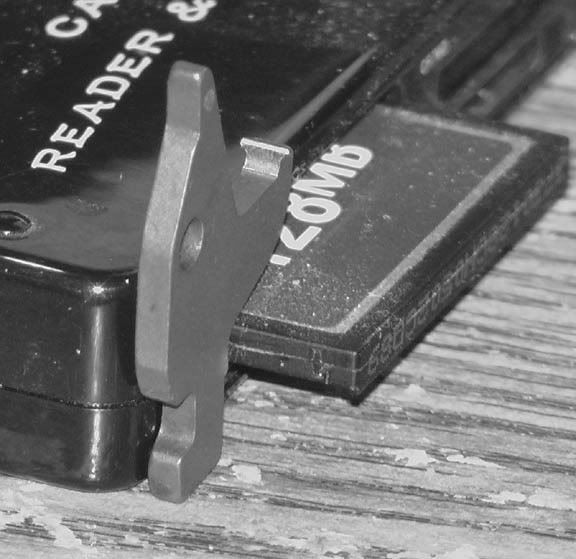

My gun started doubling at a match so after pulling the FCG I found the disco was peened at the hook and behind the hook on the body where the rear tip of the hammer hits. See pics below. My question is what is causing this. Cheap pot metal disco? Some kind of timing or bad hammer issue? The FCG has at least 1500, maybe 2k rounds though it.

OK, the bad disco hook is peened so it is wider than the normal. It has pronounced ramps on the top and underside of the hook and is worn so the hook is shorter than it should be.
I can tell that the rear tip of the hammer has been hitting the disco. That would tend to move the disco back, causing the disco spring to have to work hard to get the disco forward to contact the hammer hook fully by the time the hammer starts going forward.
Somehow the hammer hook is beating the heck out of the disco hook. My question is is this normal wear, possible being accelerated by having a cheap M1S disco. Would a too fast bolt cycle cause this? Ejection is normal, 8’ forward and to the right.

Trigger and Hammer are absolutely OK, see hammer pic below.
Both of those disconnectors are junk.
One that has your deformed hook and the the other which has the slightly rounded hook on one side.
A disconnecter should be completely flat with sharp edges and with no parting or stamping line.
Not an uncommon problem with non-milspec parts.
After replacing everything in the FCG with “US” milspec parts (not DPMS stuff) you should be good to go.
The pic of your hammer is showing wear(metal displacement) at the trigger contact edge and will eventually be a source of malfunctions. i.e. unpredictable rounds burst.
