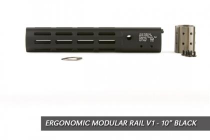

ALG EMR V1 MLOK
BCM 12.5” Kino
I’m not a machinist… But it looks like it would be simple enough to cut back the 10” rail to fit my upper.
Or, judging by what is shown on the YHM, it should be possible to cut out a section of of the 12” EMR V2:
V0 is dirt cheap right now and has the least amount of slots milled into it.
Maybe a good option to try?
The EMRs are small inside diameter though, might have to chop off the bayo lug and sling stud ears.
