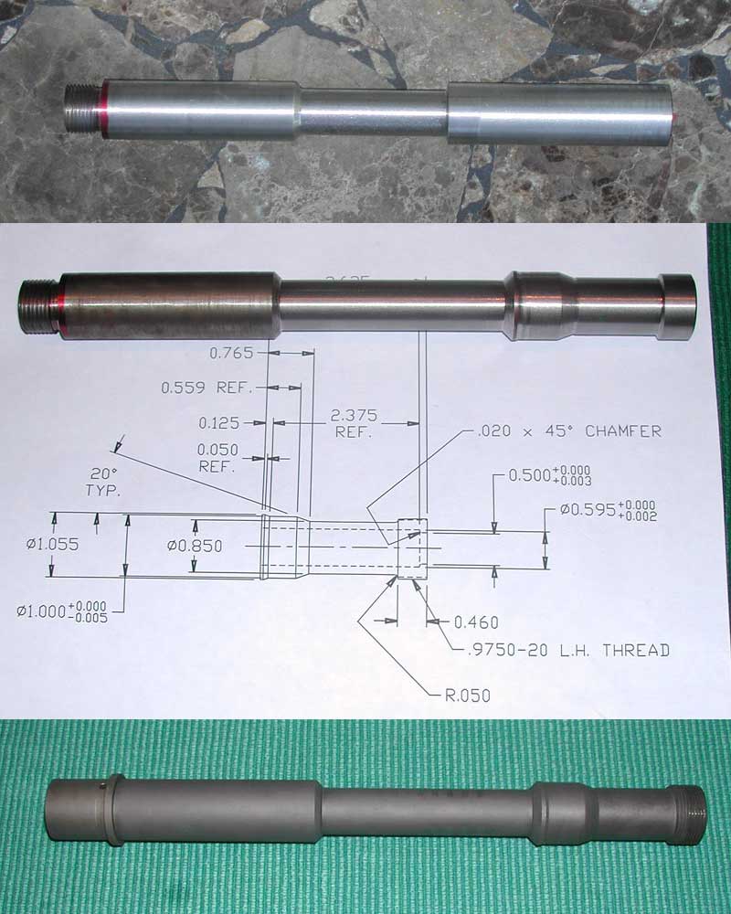

Start with a heavy profile barrel with no gas port drilled and profile the OPS mount dimensions right into the barrel blank.
Then either use a clamp-on gas block or use a larger diameter gas block than is needed to slide past the OPS mounting collar.
Here is a barrel I did years ago with an integral Troy mount:
Thanks for the reply!
Where would I get a barrel blank? I guess you say heavy profile so that use of the collar isn’t necessary right? Suppressor mounts up to the barrel instead of collar?
Are there standard barrel blanks that I could use for this if I wanted to go ahead with the collar system and standard gas blocks?

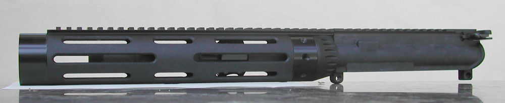

Having gone through the hassle of a custom job (M4S) with the exact same purpose in mind, on a dedicated suppressed unit, my suggestion before reading the last part was exactly the ‘10.5" and be done’, or considering scrapping the 7" VIS and going with the old school JP/VTAC, PRI CFFFT, or Spike’s BAR handguards and running them SD style with the suppressor partially covered.
From there, if you’re planning on running the VIS, cutting down an existing barrel would seem to be the preferred option - if you can find a medium contour barrel (with the right twist and CL/NC, barrel material) you’ll have an easier time with rearranging ports, although the idea I’ve been toying with is if it would be easier to have a custom machined gas block that would serve as the collar (would need a small lip on the barrel profile to butt up against) and run a LW profile barrel everywhere else, and have that gas block be a custom .625 job.
Finally, if muzzle velocity makes you difference to you, the outright simplest option would be to have ADCO make an extended version of the end-attach collar/extension setup. It isn’t added barrel, but would take an existing 7.5" barrel and be able to make it work with minimal added modification, and require zero alterations to the gas system.
