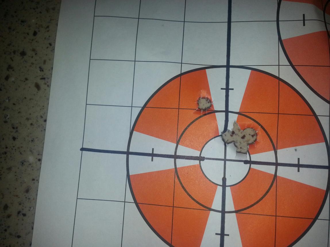

I loaded up 25 168 gr match kings with different loads of varget.
best one with one flyer.

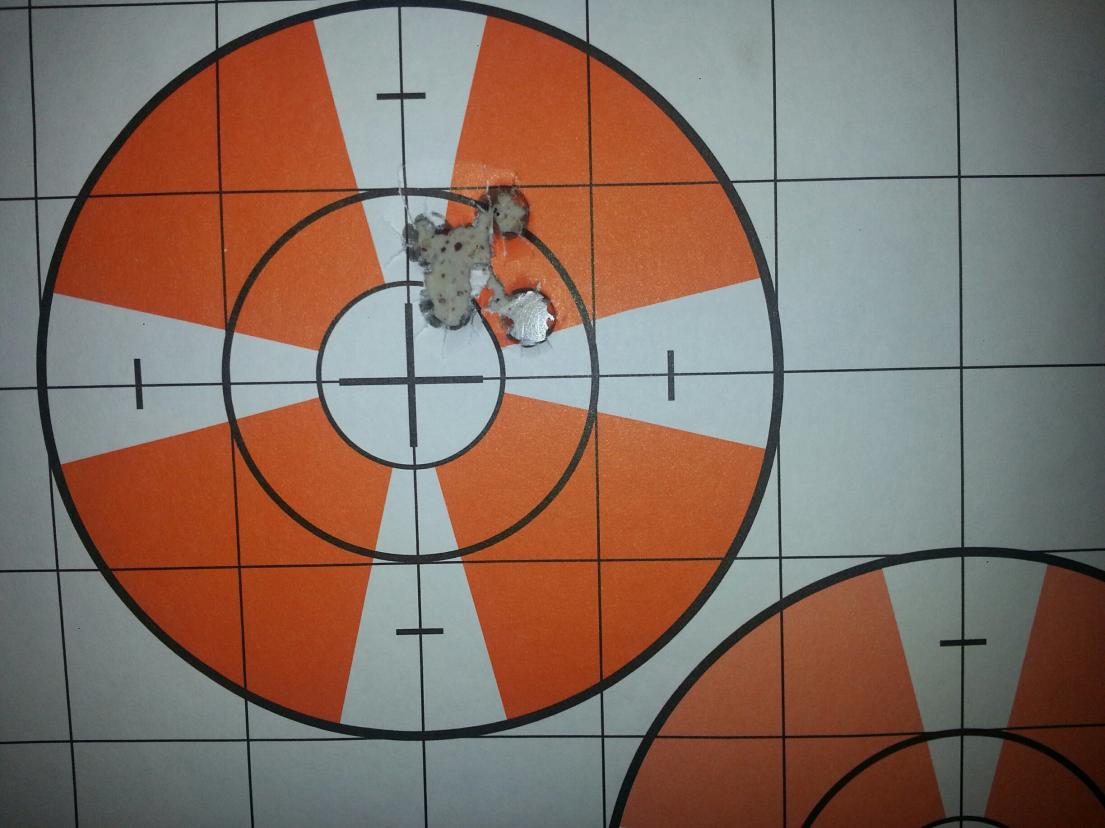

I really want to use the berger hunting VLD. Loaded them to mag length and was very disappointed. I knew that they like to be in the lands but that turns your rifle into a single shot. Did a little reading and found that they say they will jump. I was skeptical. but I loaded up 168gr berger VLD’s from in the lands (used the hornady overall length gage) and backed off .05 each 5 round group for 20 rounds total as described in berger’s reloading manual. Now I was skeptical to say the least. Didn’t really expect much so didn’t try to be that precise with my reloads or shooting.
In the lands measured 2.873. Certainly not mag length
pretty much as expected.
2.823 was about 1.5" group

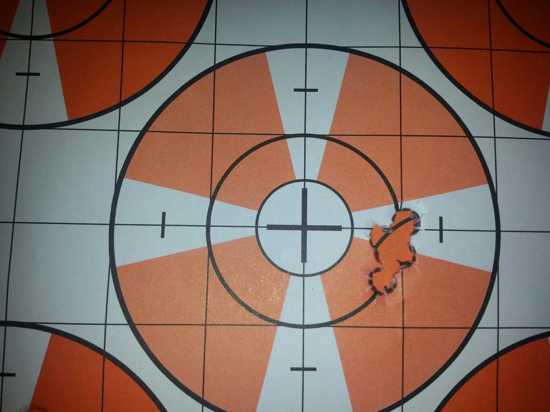

then 2.773 which is certainly mag length
I believe that will work for my deer rifle. As the gun breaks in and I keep working on my load development things may improve

Next step is to see if that group is repeatable and to chronograph that load. Its really a mild load. 42.6 gr of RL-15.
