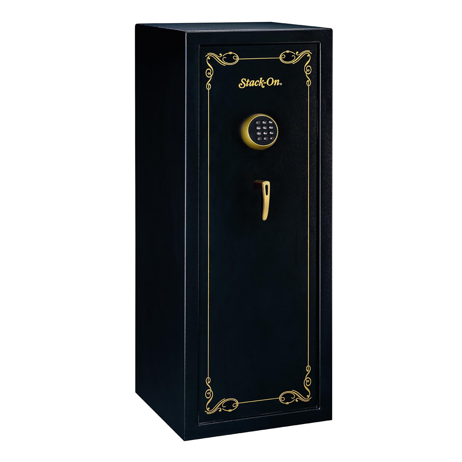

I got this one for around $400 at Gander Mountain. It claims that it holds 16. It also has a shelf at the top for hand guns or other misc. items. I love the digital lock on it…makes getting into the safe very fast and easy (but still secure). I don’t think it’s fire proof though…
http://www.gandermountain.com/modperl/product/details.cgi?pdesc=Stack_On_16_Gun_Security_Safe_with_Electronic_Lock&i=415318&r=view&aID=510L1&cvsfa=2586&cvsfe=2&cvsfhu=343135333138&cID=GSHOP_415318
Just a little nugget, but I wouldnt buy anything that had a battery powered look. Get something with a spinning combo.
