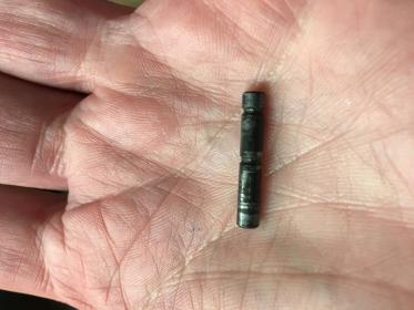

I have a 1982 Colt SP1 carbine that I bought lightly used from the original owner who claimed less than 1k rounds. I’m told it was 100% original, sighted in with unknown .223 & placed in a safe until I bought it (I paid too much, which isn’t germane). I’ve shot it twice, and both times the trigger pin walked out the left (side where the bolt release is located) & the gun jammed due to the trigger not engaging the hammer properly. The FCG pin holes don’t look “egged” oval or irregularly worn. When the first malfunction occurred, I figured the hammer spring legs weren’t in the groove of the trigger pin properly. But the second time, I know the parts (spring legs) were aligned, but it happened again shooting XM193, by the 3rd 20 round mag.

Are you sure the FCG is even the factory parts this gun came with? A factory assembled FCG cannot have a pin walk out.
The first thing I would do is remove the entire FCG and post pictures of it here.

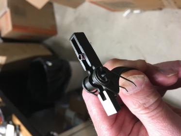

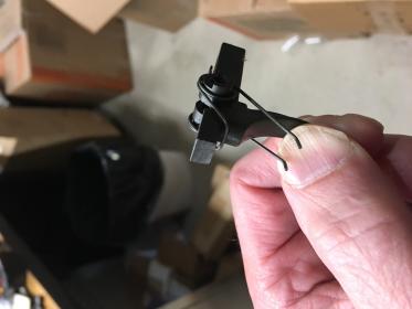

Yes, I’m as sure as I can be that the hammer & trigger are Colt as they have the ‘C’ in a circle, like my other Colt parts. So I’m fairly sure they’re Colt. If not, they went through a great deal of trouble to make copies. I was taught in an AR armorer course (not Colt, it was a local cop with connections to Bushmaster) exactly what you said about the springs aligning in the respective pins & grooves and was taught the aftermarket retainers for full auto (anti-walk pins) weren’t needed. My first thought was the hammer spring wasn’t installed properly or was bent, but it looked fine.

As a general rule, for collecting, your rifle need to be in factory original condition. You can replace worn parts with original factory parts if you can find them. If parts are marked and are serviceable I would keep those and continue to use them. The hammer in the photos is standard for the Colt SP1 because Colt did not want to use full auto parts. Unmarked parts like springs and pins can probably be replaced without harming the collector value, but a real expert on collectable firearms should chime in here.
If you want a shooter then feel free to replace what ever you want, but I would retain the original parts so it can be returned to its original factory condition.
In my case I replaced the original front pivot pin which uses screws to hold it together for an after market quick detachable pin and I replaced the flash suppressor with a three prong type. However I still have the original parts and who ever gets the rifle after me can restore it if they want to.
Thank you. If I were to resell it, I would keep the chrome, smooth BCG & replace the semi BCG. I’ve swapped trigger & hammer springs & buffer to Colt H1, but the original parts are in a baggie, in the case.
