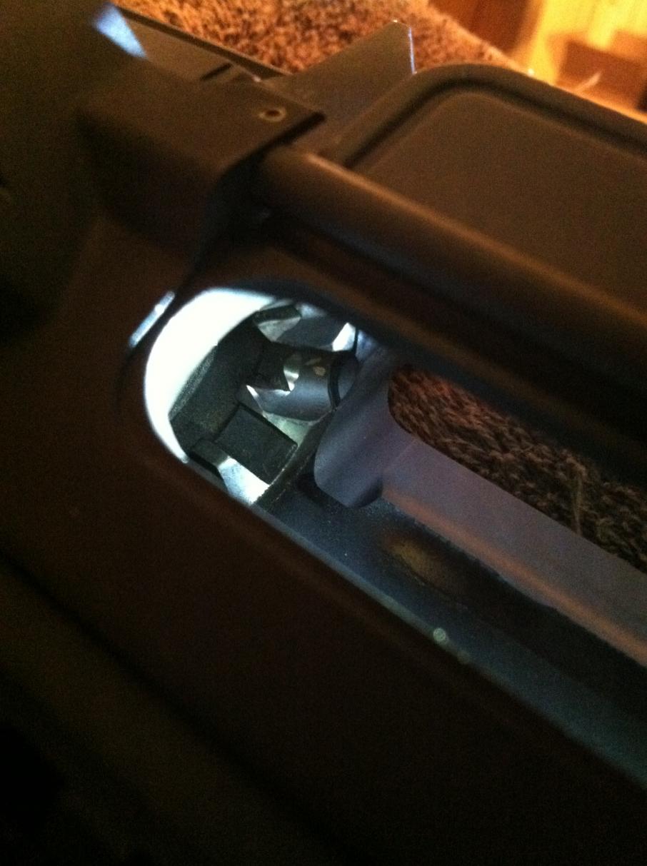

It appears to be new & only test fired but it appears to have some dermal work done to the feed ramps of the barrel extension at the locking lugs. All the dremeled areas are in the steel barrel extension not in the aluminum receiver.
Question for colt LE901 / SP901:
Does your barrel extension have dremel work done from the factory?
If they did “Dremel” the barrel extension, it was prior to the finish being applied.

They may have polished that area with http://www.cratex.com/cratex-points-box-of-100/
It’s not uncommon for Colt to polish feed ramps here and there. When and why they choose to do it is a bigger secret than Victoria’s.

I have a take off Colt 5.56 barrel that I picked up off of Gunbroker. If I remember correctly, it has a 2012 date code and it has nearly identical polishing on the feed ramps. Obviously it isn’t a factory sterile example, but I can’t see why a guy who seems to buy Colt rifles, take them apart and sell them for parts would bother trying to polish anything.

All 7 of the factory fresh Colt 5.56 carbines I have seen since 09 have had their ramps polished identical to the ones in the pics above.

I do have some slight polish marks on my feed ramps. Looks like a little bit of polish paste to me. It cleaned off easily.
Shooting it for the first time later today.
I have an unfired 2013 colt le6920 still in the box, just opened it up and checked and it has the same polish marks. Seems to be a normal colt factory thing and not a problem. The opened accessory bag and scratches and incorrect stock would bother me though.
