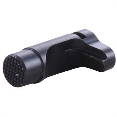

In my opinion, what you are experiencing is the top edge of the magazine incorrectly interfacing with the lead in chamfer on the bottom of the magazine release. Unlike the Colt magazines, Wilson and Tripp magazines have the thickest allowable magazine tube dimensions for strength and durability. Occasionally the thick mag tubes are wide enough to “over engage” the lead in chamfer of the magazine release. You can see the lead in chamfer cut on the bottom of the release (right side) in this picture-

Regardless of whether your magazines have or don’t have a detent, in my experience, the fix is to increase the magazine release’s lead in chamfer, so that the release can be properly and smoothly moved out of the way by the thicker tubed Wilson and Tripp mags. If you know a good 1911 gunsmith- increasing the mag release chamfer is an easy fix. I know the Colt Custom shop can remedy this for you also.
