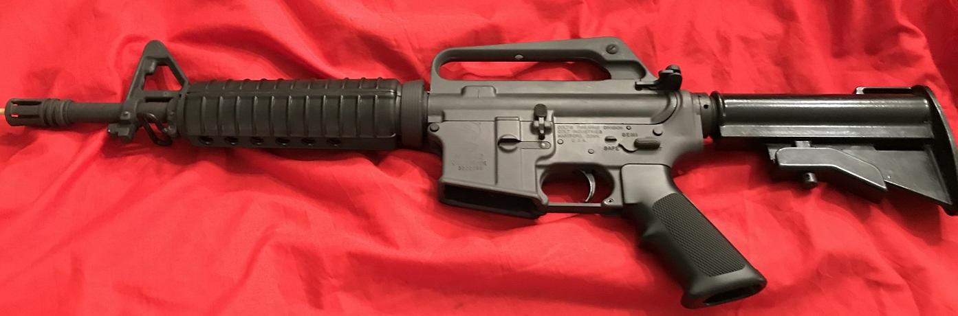

I have a question on this Colt I encountered. It seems to be an earlier Colt M-16A2 Commando 733. The selector is a safe, semi, and burst, and the gun has the select fire internals.

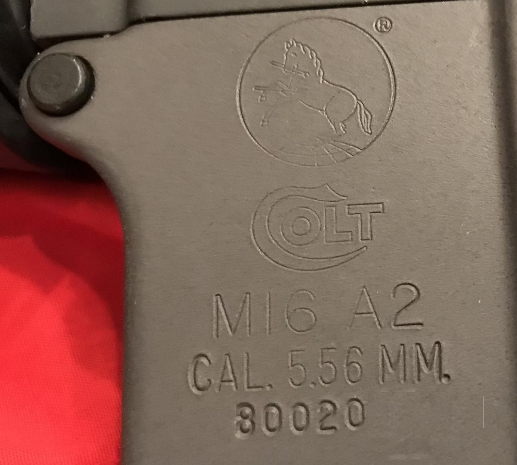

It has an 11.5" barreled A1 upper with A1 rear sights. The lower does not feature the name Commando, but is marked as a M16 A2 and comes with an M-16A2 style pistol grip, which was later replaced by a Tango Down pistol grip. Also the name Colt and the stamping of the rampant pony seem to be very shallow when compared to every other Colt AR-15/M-16 that I have encountered. The light stampings for the Colt name and symbol make me wonder is this gun legit, or some unusual sample done on a day when they were not paying a lot of attention to the stampings?
Attached are some pictures.

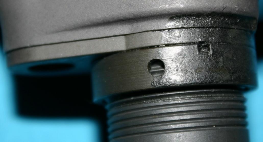

Can you take some photos of the castle nut and receiver endplate staking on both sides? Never say never with Colt, BUT I gave it on good authority that no Commandos left the factory with burst marked lowers. There were a good number of transferable stripped m16a2 lowers that were sold off to a handful of dealers in the 1990s, those trickled our and were built up by owners. Before paying big money for an A2 commando, I would do some due diligence re: the provenance of the configuration. Or just price it like a regular A2, not a rare transferable 733.
Many factory Colt m16s and AR15s have light rollmarks on the magwell. My 614 is similarly light in the magwell rollmark. I’ve seen many A1 and A2 posted for sale over the years like this as well.

I’m no expert at all, but my vote would also be that this is an M16A2 rifle lower that someone built a 733 clone on.

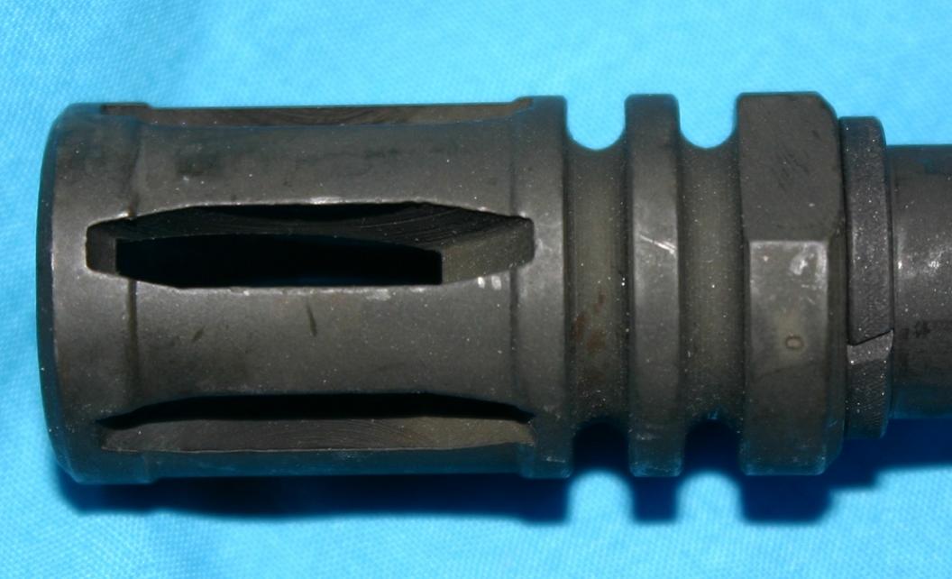

It also looks like it has a crush washer behind the flash hider, and I believe a factory 733, particularly an earlier one with an A1 style upper (vs the latter C7 style they had later on) and vinyl coated stock, would use a peel washer instead.
Looks like a mid-80s thru early-90s commercial A2 carbine prior to SOCOM adopting the M4A1. It should have an A1-profile barrel with 1-7 twist and A2 flash hider.
The proper buttstock would have been the plastic carbine stock vice the vinyl-acetate covered “CAR-15” stock – but those were “iffy” as well, depending on contract dates.

Here are some photo of the staking:
Your A1-series nut is not staked and the upper has no brass deflector hump.
Looks like somebody built it from a rifle. Not necessarily a bad thing, but you’ll need to write Colt for a letter of provenance to know how it left the factory.

The Upper appears to be an A1–it has an A1 flashhider
Here is a closer picture of the flash hider.
Ah, seeing it up close that’s the old style lock/split washer. That’s what the A1s and presumably also the pre-A2 carbines like the 653 used.

If a carbine, it did not leave Hartford without being staked. So someone either swapped stocks for a modern 4-POS RE or it’s a parts gun. I suspect the latter. Not undesirable, as it’s a transferable Colt A2 lower. But from a collectability standpoint it has a few black eyes. I would not pay any premium for that. I personally would not pay much more than FMV for a garden variety Colt m16a rifle for that particular Colt. If it did start life as a m16a2 rifle, some of it’s collectibility has been lost as a result of it no longer being in the configuration from which it left Colt.

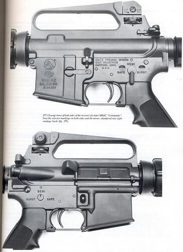

Interestingly on p, 354 of the book The Black Rifle Volume 1, there is a picture of the 700 Series A2 weapon family that shows a Colt 733 Commando with an A1 style rear sight and no forward assist.
However, on page 355 of the book there is a picture of a Colt Commando that shows an A2 style rear sight.
However the markings on the lower of the gun in question are identical to the markings of the lower in the book.
Below is a picture from the book:
Thanks. I looked it up. I got the response of Serial number not found.
I tried several Colt AR Ser# and got the same result. Ed, the photos you posted of the Commando from Black Rifle match the description of the 753B listed in Black Rifle II pg 273.
With the exception of the bayonet lug, your rifle matches the description of the 734A & 735 listed on the same page.

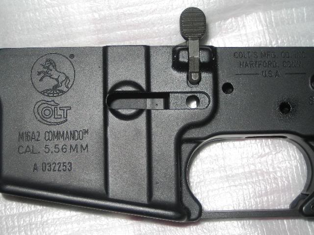

To make things more interesting, I managed to find a picture of a Colt Commando receiver on my hard drive. No telling where I got it from. It is actually marked Colt Commando.

I am attaching the pictures:
