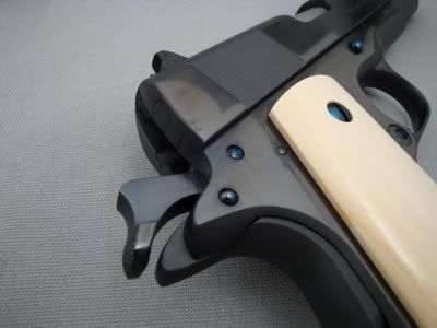

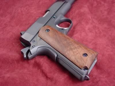

This is the only man who I will have work on my 1911’s>www.harrisoncustom.com IMHO there are no better, but others who are equal. Plus he is a class act and GREAT smith to work with. I have a hard use in the works with him now built off a new SS Series 70 Repro…
Here is what he did on my WWI Repro “Retro” He used Turnbul for the finish.

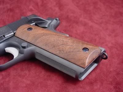

We love to do retro guns. Like a street car body with race car guts. Some of the things that people do to gun are over the top for others.
This gun is a gun we built out of a colt 70 reproduction gun.
The difference in my mind in the type of gun you would like to have built for you is your personal touches we would love to talk about it with you.
We had a customer do his version of a retro not long ago.
To me this gun is a nice gun but it is not retro. I love the gun so much that it hurts me the build just grew and grew as we went.
