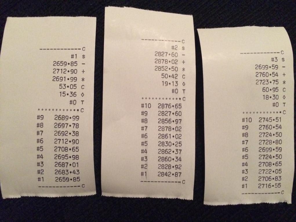

Okay everyone, went to the range today and shot a few strings of black hills ammo. 29 rounds of 77 OTM (mk262 mod 1) and ten rounds 69 grain OTM.
I think everyone here knows my rifle. Here is an image of my results string one and three are the BH77gr OTM and string two are BH69gr OTM. I know I did only 9 on the first string, had a guy in my ear and didn’t count right. As expected the heat increased my average velocity on the third string to 2,723.75 FPS as compared to the first nine shots of the first string only averaging 2,691.99 FPS. Either way it seems my reloading is just about matching the velocity of black hills mk262 mod 1 out of my rifle.

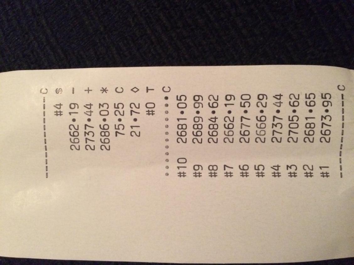

Here are 10 of my hand loads using Sierra 77gr OTM with 23.1 grain 8208xbr 1.869" to ogive and #41 CCI primers cases trimmed to 1.750" and crimped. I do plan on upping my powder charge and changing primers.
Don’t ask for the grouping size, it’s nothing special when you have someone on the range shooting a 50BMG just a few lanes away from you. I know you’re not supposed to take out flyers but if I take those out the group falls at .822" first string and 1.870 with the flyers. Third string no flyers is .634" with flyers 1.635". The first string had five flyers and the third string had four flyers. These two are results of the mk262 mod 1 from black hills. Take out my flinching when a 50BMG shoots next to me and these rounds are fantastic Also this shoots 1.5" high at 100 yards and also rings the 10" gong at 300 yards without adjusting scope elevation.
