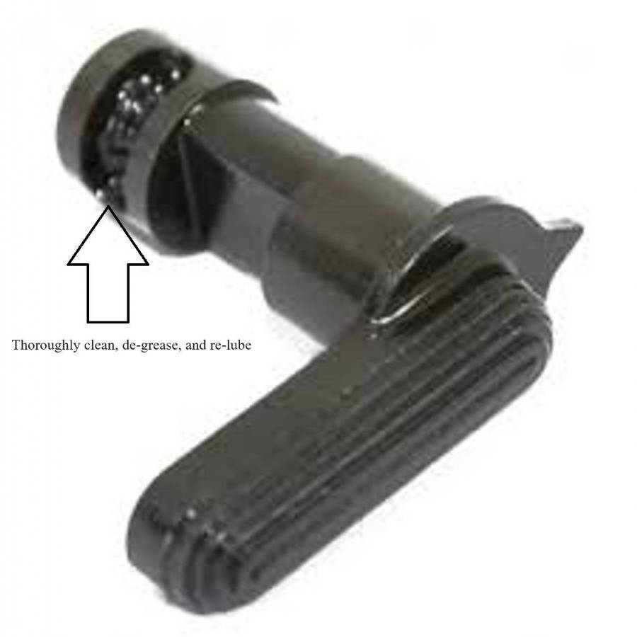

Just detail strip and clean the stuff off the selector, spring, and detent.
Remove the pistol grip minding the springs and detent don’t lose them). Clean the smeg out of the groove and selector stop holes in the selector shaft. Lightly lube with a good oil and reassemble.
That’s what I told PB yesterday. We’ll pop the grip off an put some CLP down the hole.
