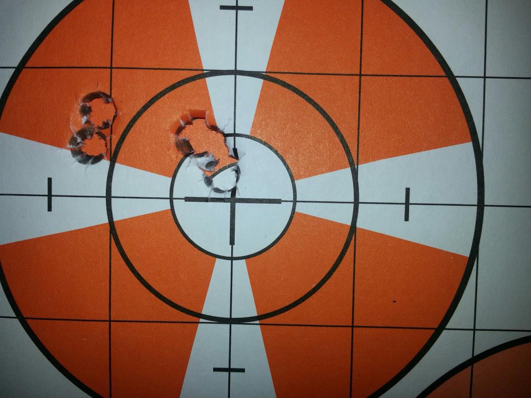

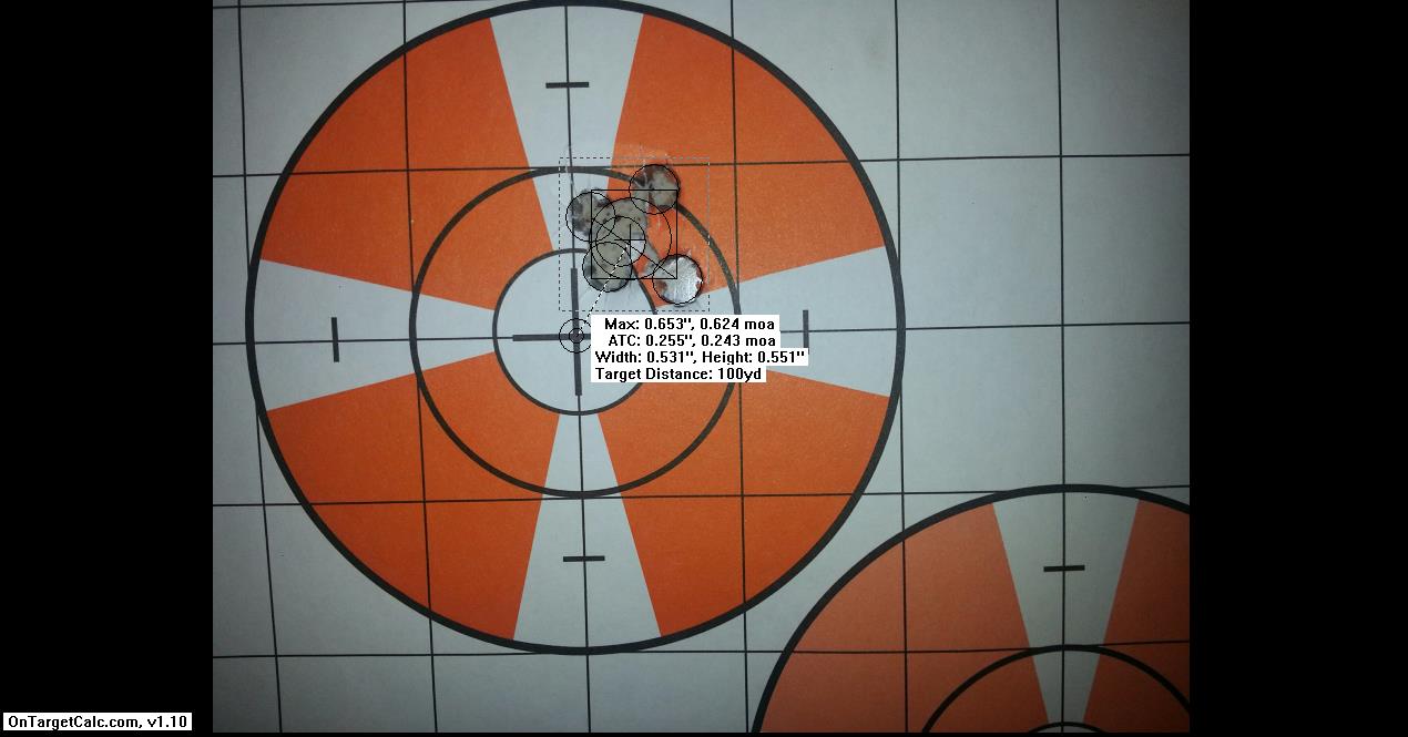

Everybody thanks for the replies. Makes me feel less guilty when I don’t clean it. It really does make a difference. I didn’t clean last weekend when I went to the range. I was beginning to think like you guys. This time groups were tight from start to finish. I shot 25 rounds last weekend and 40 yesterday and 40 today. Looking for that right combination of bullet, powder, powder charge and COL. Now this is just my deer rifle. Not a bull barrel but a #3 contour and I have a 2X12 illuminated scope with really heavy crosshairs. I keep thinking I will put my 4X24 duplex non illuminated on it for load development but I have to keep telling myself this is just a deer rifle not a 1000yrd gun.
Dirty barrels shoot good. this was a load that I found a couple of weeks ago. 168 MK and 42.9 gr RL15
I really want to use the Berger hunting VLD. Bergers like to be jammed in the lands. That makes them a single shot. Trying to find that magic COL that they will jump from. Haven’t done it yet.
