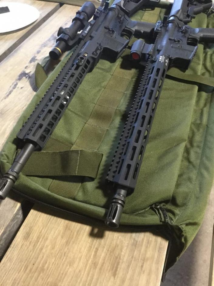

Thoughts on this?
Sorry for the Ipod pictures, but I think the visuals tell the story. I own and use both types, so not trying to advocate either way, it just seems intuitive that clamping on the bottom would try to “open the box” at the top. . .
I sit here, and wonder about these things :big_boss: :wink:
It’s correct - hard to argue with that. What’s your question?
I guess I wonder why manufacturers seem to gravitate toward clamping on the bottom? Is there a reason we as consumers might not be aware of?
