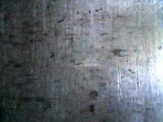

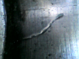

Gunsmith make a house call this AM
The chamber: scarred & pitted & below SAAMI specs.
Well on the bright side if it’s under SAAMI it could be cured with a chamber reamer if that pitting/scratches are in a spot the reamer will correct.
I’d just send their trash back to them though.
