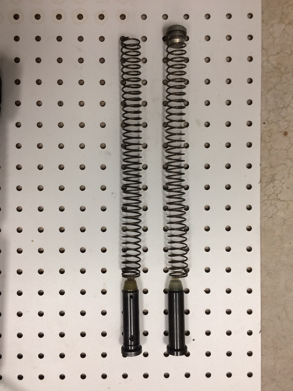

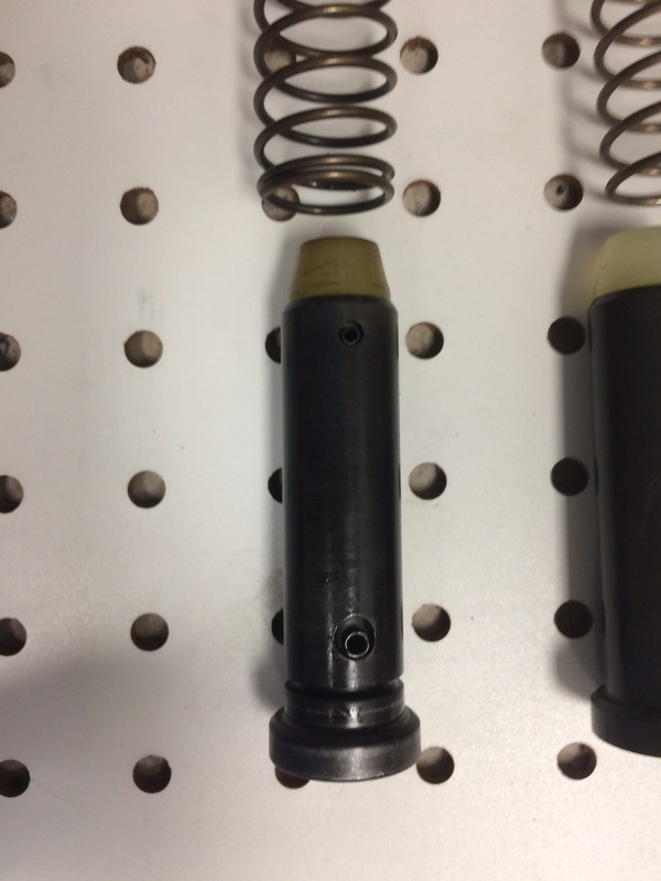

Though I don’t know about the weight, they do not look the same. The RRA is on the left and the one from my Colt SBR is on the right.
The RRA has a roll pin through it that allows the rear of the buffer assembly to slide front to rear relative to the rest of the buffer assembly.
I can’t figure out what the thought is behind the different design.

Interesting. My 9mm Colt carbine that I bought new about 15 years ago has a buffer that looks exactly like the RRA you pictured. Is your Colt a newer model? Searching Colt 9mm buffers show the design to be just like I have.

That’s interesting. I bought the Colt SBR about a year ago.
I bought the Colt 9mm SBR right at a year ago. I just checked the buffer that came in a Tiger Stripe finished Colt 9mm receiver set that I bought last June. It’s the same.
