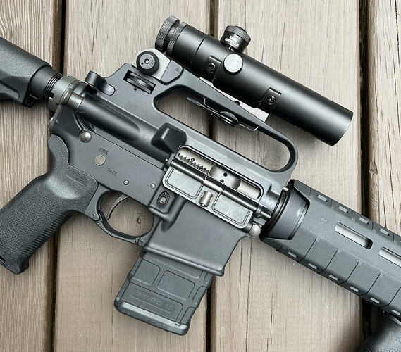

My first AR and 4x. Integrated mount keeps scope as low as possible (near identical height to my Unity/T2). Spring tensioned mechanism. Brownells sells a Colt 4x replica with similar mount design. There’s dime store options on Amazon.

I’m going to give my mount one more try and if it still won’t hold, I may go your route. Sweet looking setup btw.
