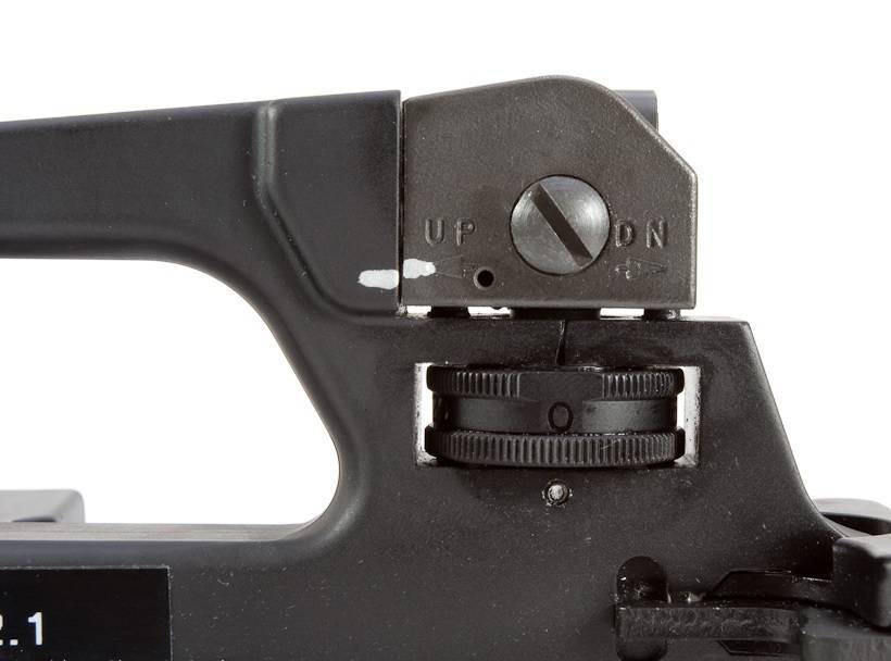

Carry handle question
It sounds and looks normal to me.
100% normal / within spec. Welcome to the A2 / A3 sighting system.

Wouldn’t it allow you to sight through a circle instead of an ellipse?
The center of an oval (if you can even tell while firing) is the same as the center of a circle. I’ve fired out to 500yds on known distance ranges and approx 500yds on unknown distance and it didn’t make a practical difference. The rack grade rifle still made hits to the capability of the ammo. To reliably produce a basketball size group on target at those ranges is obtained by properly dialing windage and elevation combined with basic fundamentals.

That’s a standard A2 / A4 rear sight.
There were two ways to fix it for those with Obsessive-Compulsive Disorder, or National Match shooters.
  1. Weld a small “Tit” on the right side of the housing and file it down to ensure the housing is exactly parallel with the handle’s U-notch, or
  2. Have a machinist drill straight down the observation hole in the top of the sight and insert a pin to ensure the sight has no left-right movement. This one is double-pinned:
These practices have pretty much “Gone away” now that National Match shooters use 4.5-power telescopes.
Why does that drum have a 0 on it
Isn’t the National match drum marked in number of clicks, starting at zero?
So my guess is it’s a NM drum

Yes. Some sort of competition sight. You can tell by the app in the base… Now with that App, you might not want any sight base cant due to it’s length.
Yes, I was talking about Compass Lake earlier.
All of my hooded rear sight bases from them have interchangeable apertures. You can fine tune exactly how much light you want coming through. And no, they don’t have to be ‘pinned’ to be hooded like that and still work well.
