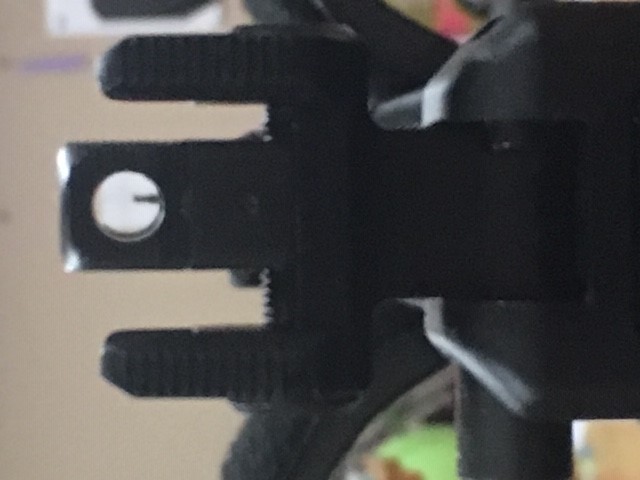

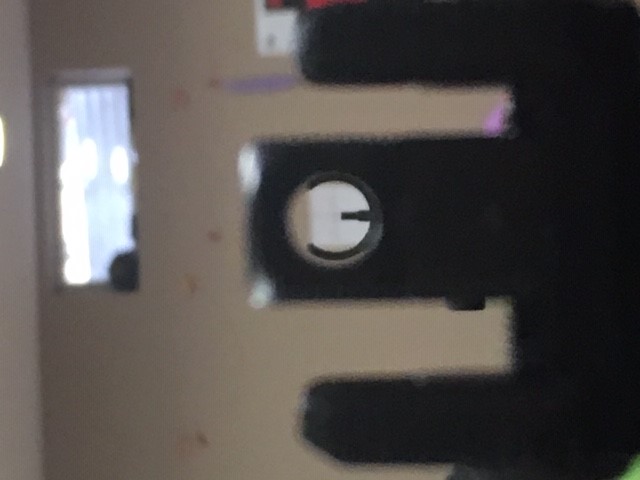

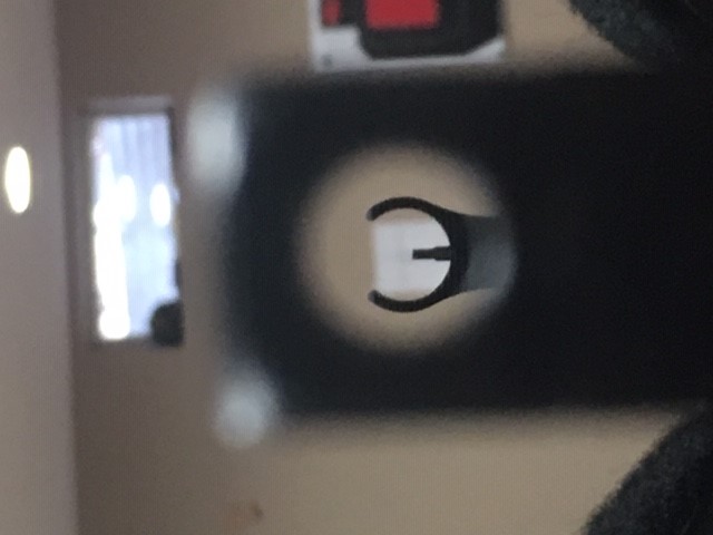

Thanks! Funny thing, looking though the bore and then using the SL-500 laser boresighter matched up perfectly. The front sight post seems WAAAY too high, but windage appears okay from the factory
It’s going to be too high at 30 feet, so don’t worry about it. Just go out and shoot it. You’ll be pleasantly surprised at how close it is.
Maybe they want your first round to go in the dirt instead of sailing over the trees.
Looks better now, after adjustments. Had to bring front post down a lot and move the rear windage. Oddly, to get a good sight picture the rear sight is off center of the housing a bit.
