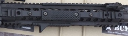

What rail or who makes AR10 rails ?
PB
This rail :cool:
