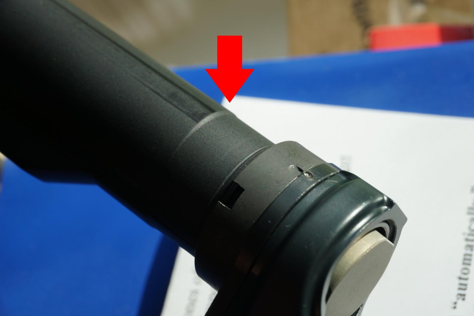

Hey guys,
I put my lowers together over the past month and noticed on my buffer tubes that somehow a ridge has formed between the castle nut and the rest of the tube. Across the three lowers, they all have the ridge but to varying degree of severity. I’m gunna try and post a pic of it below. Is this normal?
Edit: Also, the buffer tube is LaRue (I’m still waiting for their CS to handle my problem, it’s been 4 months). QD Plate is Impact Weapons (I think it’s the best QD plate and the CS from Earl is fantastic). Castle Nut torqued to spec.
Also, I ran my fingers inside the buffer tube and it doesn’t seem to affect the inside of the tube.
Haven’t ever seen that before…
Yeah neither have I…
I wasn’t doing anything odd either, just Geissele Reaction Block, Magpul Wrench, and a torque wrench.
I’m betting the ridge was already there from manufacturing, you just didn’t notice it before. LMT tubes have a similar ridge, although the location is slightly further back.
Looks like your tube was turned in a lathe prior to thread cutting.
Most tubes have rolled threads, not cut, hence you might never have noticed before on other tubes.
Your tube is fine.
This is what I’m thinking
Okay, I wasn’t sure. It seems strange that the ridges are either bigger or smaller depending on the buffer tube.

How could you tell the threads were rolled or cut?
Not sure if it’s 100%, but if they are tube OD they I assume they are cut. If the threads OD are greater than tube OD, I assume they are rolled on. The end of the thread where it stops and goes to the tube is different as well.
Hopefully someone with more technical knowledge chime in.
If you have two to compare it’s obvious. Sometimes you can tell on the last few threads if it is rolled as the top of the thread will be “M” shaped. Unfortunately, since this looks sloppy, most quality places turn the last five or six threads flat. Also, if the thread ends suddenly - it’s cut. Rolled threads usually fade out over a quarter turn or more.
But honestly, most places that make mil-spec diameter extension roll the threads in, its easier than cutting them, even the “mil-spec” UTG extensions have rolled threads.
If you are really worried about such things, just buy from a well known and respected seller…
Well, I mean LaRue is supposed to be a well known and respected seller…
And the ones I’ve seen up close and in person look rolled. Just because they machined the last few threads to clean them up and put a slight step in it doesn’t mean the threads aren’t rolled . . . (see below)
