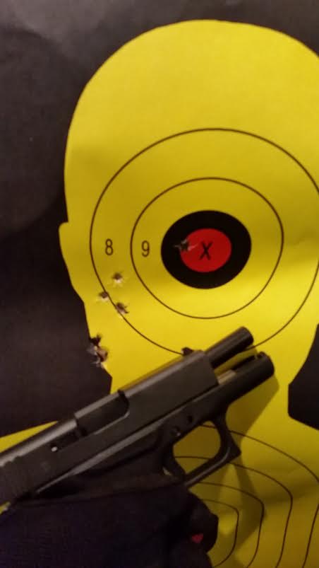

Very first group, just getting a feel for it.
The second magazine tightened up a bit. I had a hard time beating the second magazine.
