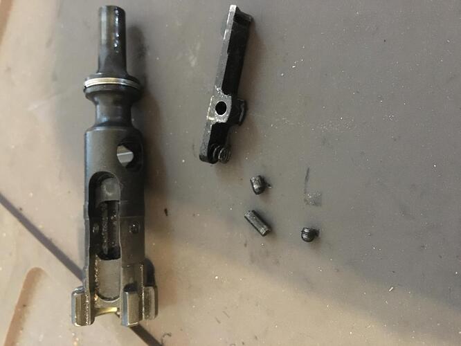

Broken Pin
This was in a 10.5 SBR and is an AR Stoner bolt. I started having feeding issues and when disassembling the bolt found the broken pin. Is this normal for an SBR that might be harder on BCG parts, a cheap bolt or combination of both?
Ordered a BCM SOPMOD bolt upgrade kit to replace parts.

Probably a bit of both. How many rounds?
Round wise as an SBR bolt, I would estimate 300, when it was in my patrol rifle before upgrading to a Colt LE 6920 for work and misc. shooting, alot is all I can say.

All small parts are not the same, and I think we all know many of the smaller parts come from a few main suppliers. Pins and springs are horribly important, and are the same in their birthing status. Cheap bolts assembled with cheap parts are often stocked with parts which should have failed QC and been thrown in the dumpster.
Sticking with known good parts like BCM, Colt, etc, does NOT cost you more. I know that is hard for some people to imagine. Buying subcontracted junk parts isn’t saving money, it’s rolling dice and hoping.
IIRC I had read in an old post here advising that Colt uses an S7 tool steel pin there.

The key to this statement, that most should heed is that there are only a few vendors for many of the small parts. So when the big boys like Colt test a batch and that batch fails, the failures get sold off to the other companies. Almost guaranteed, when you buy parts that say, “gov contract/contract overrun/mil supplier,” but the parts don’t say Colt or FNH, you’re buying trash that they rejected. Even if it doesn’t say something aluding to military pedigree, chances are high that they are actual mil supplier rejects.
