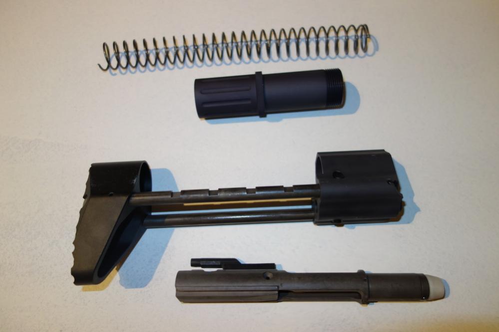

He wants to use an extra short buffer tube and showed me this today:
And the NEA:
It might be easier to chop it off and add a tail piece like the Colt SCW in the photo above than to turn down the OD. I think he may have a Bushmaster carrier that he’s going to let me hack on. If the project goes anywhere, I’ll add an update.
ETA: Does anyone know if the NEA carrier has any buffers in the rear or just the plastic tip?

Quick update - I received a Brownells M16 bolt carrier (don’t know who makes them for Brownells) and turned down a portion of the rear, leaving a shoulder for the buffer spring to seat against. It looks similar to the NEA bolt in the photo without the plastic tip. I decided to try turning it first because that still left the option of chopping if off if I totally FUBAR’d it. While it was pretty hard, a good coated carbide insert handled it. The bigger problem was the slot that runs lengthwise down the bolt. This gave an interrupted cut that busted the tip off my insert twice.
Taking light cuts (about .010 to .015) I was able to whittle it down and keep the cutter intact with a good surface finish and gave it back to my customer. If I had to do a bunch of them, I’m sure there is a tougher carbide insert that could handle the interrupted cut that would be better suited for the job. All in all, it was a fun challenge.

He’s trying to make a shorty/PDW 300BLK using something like a 4" pistol buffer tube.
