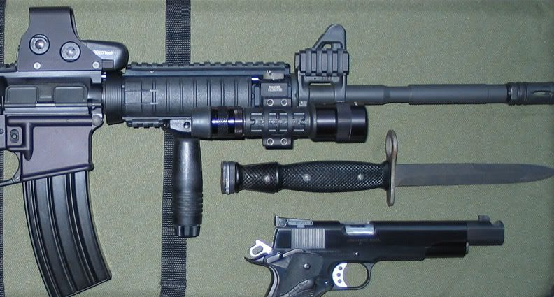

Pic of my Bo-Mar sight flush with the slide on my Wilson Combat-Colt .45, the slide have a milled groove at the rear so that the moving part of the sight is in the groove
