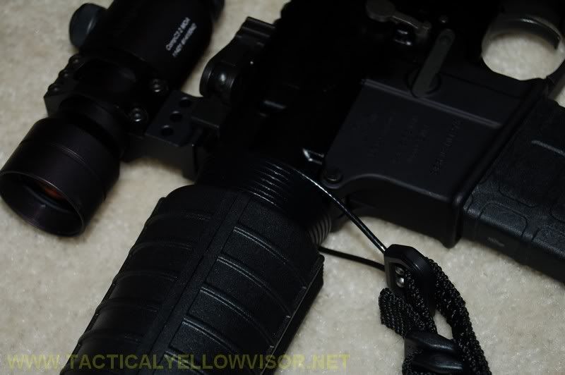

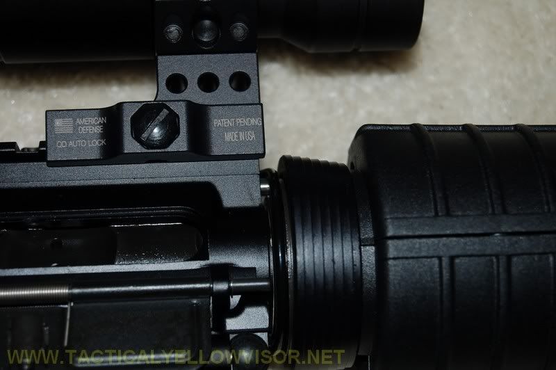

Promised photos. They suck (black object on light carpet, bad contrast) but they’re here.
Interesting, thanks Rob. Any concern with it applying pressure to the gas tube?

When I first installed it I just pushed it back on the handguards. This was, for me, a no go. For one thing no matter how far back I pushed it and how tight I wedged it onto the taper of the handguards, it would eventually come loose and move around. For another thing, it wanted to rest at an awkward location when it was “locked” into place. Being neither fore nor aft it was just wrong.
As to the gas tube, I’ve heard that concern from others. I’m not worried about it, but will deal with it if it happens. The location is so close to the hole in the receiver that it’s not going to bend the gas tube significantly. The only thing it could do, in theory, is crush it and with the light weight of this rifle I don’t see that happening.
