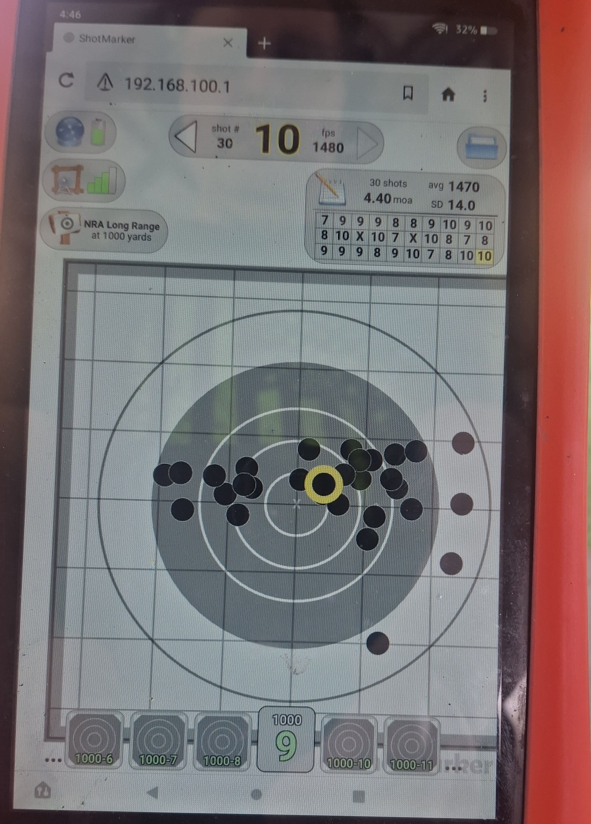

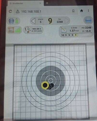

Yea,I agree,the 6.5 ain’t got much ass left @ 1K but I’m just shootin for fun and accuracy and nothing super serious. Here are a couple groups @ 300 and then @ 1K with the 147s,I was pretty happy to say the least for a factory/stock rifle. It is a little bit older of a Remington so that could be a good thing,LOL I am content for the most part with the 147s but just figured I would try the 153.5s,I only bought 1 box with some other goodies from Creedmoore Sports so I threw them in with everything else.

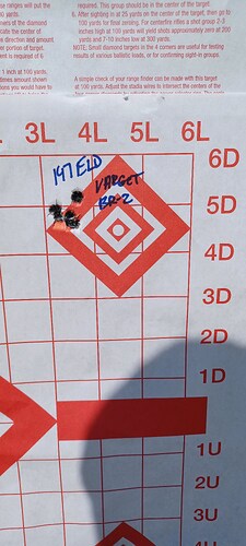

Here is a group with the 147s and Varget,I have since gotten better results with H4350,I’ll go see if I can find a pic.

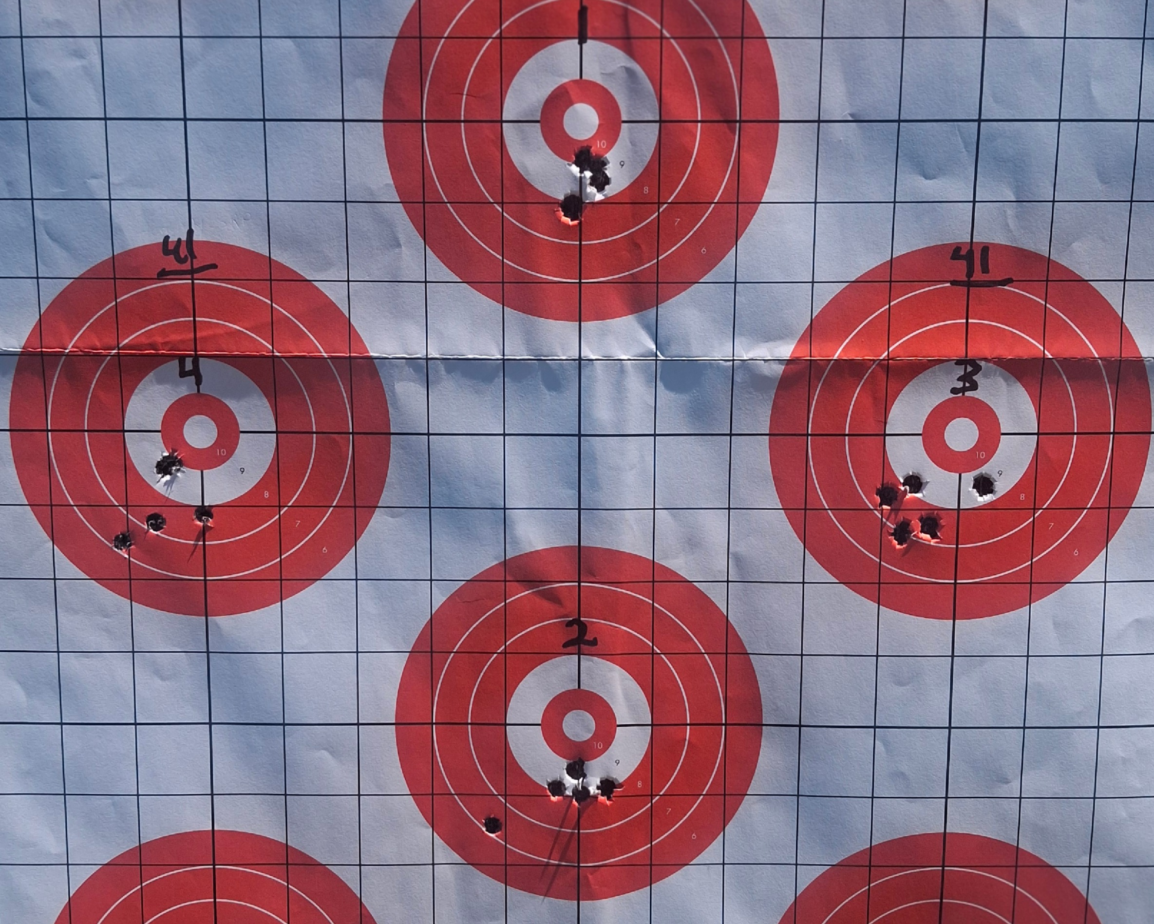

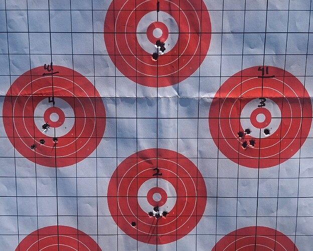

Here is a pic of the targets.1&2 are the 40.5 loads and 3&4 are the 41 grn loads. The 2nd group (#2) of the 40.5 had better ES and SD but group not as good as the 1st I did pull the one lower shot but felt good about the rest. Anyways for you 6.5 guys maybe this is some good info or maybe not but had a good day at the range just the same.
