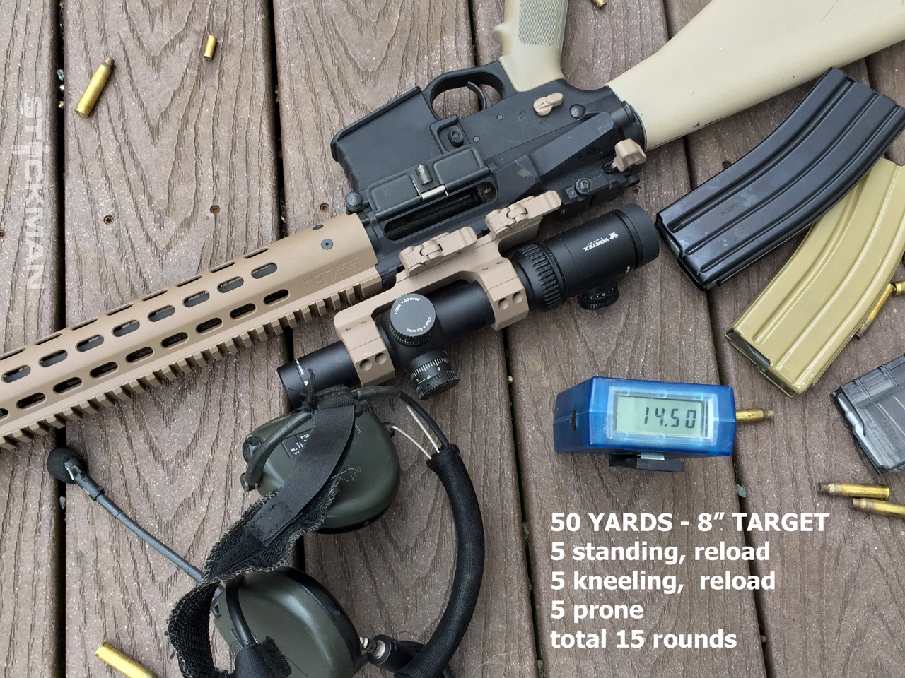

A few minor mods based on ability and location at the time. This was shot was a 16" rifle gas length (15" rail) and Vortex 1-4 optic. The distance was a slightly less than 50 yards, I would call it 45, which might not sound like much of a difference, but it is. The trigger is a stock USGI type semi auto trigger. I was using a comp, which worked very well. I don’t have much question that a “good” trigger would have made a world of difference. The magazines were NOT grabbed from secured pouches, rather, they were laid out with easy access. In addition to the above, I was shooting a steel 8x11 target which obviously gave a lot more room for error. Last, but certainly not least, I wasn’t able to go prone. I fired 5 standing, 5 kneeling, and then went back to standing (reloads in between). I don’t feel all that bad about standing instead of going prone as prone shooting is easier for just about everyone. Anyway, not exactly according to the rules, but the variations are out in the open.
Stick that is good shooting. Standing is defiantly the slowest (for most people). Hard to get an apples to apples comparison given the mag placement and such but that’s still undoubtedly quick. My heart is so happy to see people discussing shooting on this forum :slight_smile:
I just like giving 26Inf a hard time. He’s the Mr Wilson to my Dennis the Menace!
Thanks for sharing man. Didn’t mean to call you out in the other thread. Always happy to get more feedback as to what folks are doing to get more proficient.
Magnification, mag placement, distance, and slightly larger target certainly come into play, but the shooting felt good and no fumbles or “oops” with mag reloads. Some days it seems like I can’t miss, some days I wonder why bullets hate me.
The comp made a big difference. Once the sights stay on target when the shots break, it is a different game. I need to shoot the drill with honest distances and sizes, and with an A2 muzzle device.
