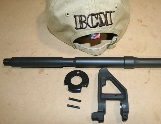

Stripped Barrels
Using my postal scale,
16" M4 Profile BCM barrel is 1lb-11.9oz
16" Mid Length, Gov Profile BCM barrel is 1lb-11.6oz
.3oz difference between the two barrels
That difference is so small, that I think only a scale could really notice the difference. So in practical terms, they are the same weight (before the additon of specific handguards).
Thanks!
