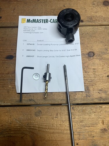

A barrel dimple does two things;
  1. Ensures proper gas block alignment
  2. Ensures the gas block does not move
To dimple your barrel the following tools will help to ensure its done properly:
A Dimple Jig (by SLR)
A 5/32 drill bit
A 5/32 drill bit depth limiting stop collar
A 5/32 transfer punch
A 5/32 washer

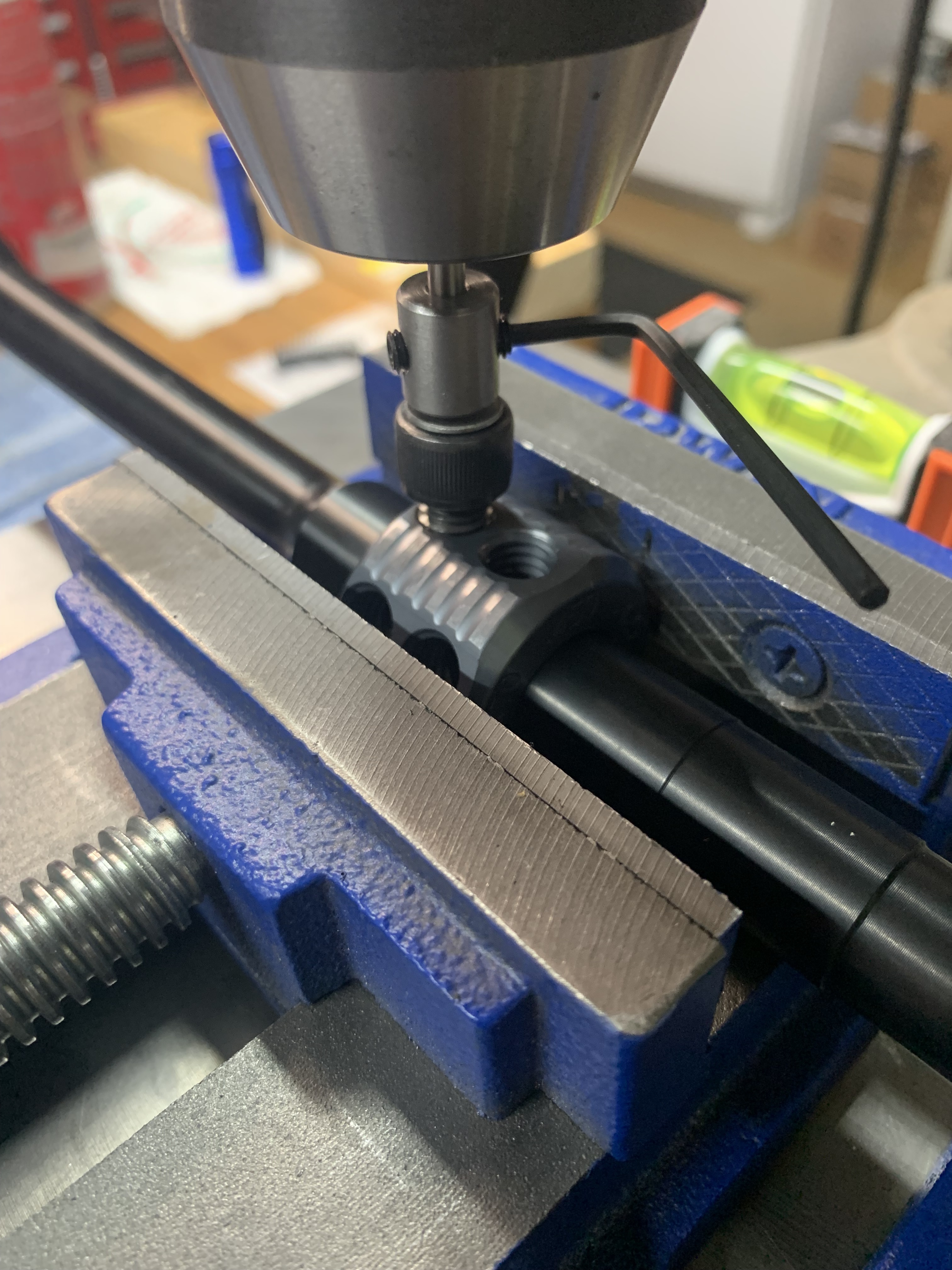

Place the dimple jig on the barrel and align the pointed set screw in the gas port then snug it down. The larger drill bushing screw should be directly opposite of the gas port.
Note:
Only one dimple is recommended.
Next, place the jig and barrel in a vice or drill press.
Now set the drill bit depth limiting collar and washer in the drill bushing and tighten the set screw. Then remove the washer.
*The thickness of the washer will be the depth of the dimple.
Before drilling place the 5/32 transfer punch in the drill bushing and give it a couple taps. Now its ready to drill.
