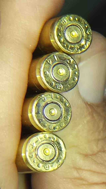

Finally found time to fire some LC 14 M193 through the UCIW stock assembly. Here’s the best picture of that ammo after being fired out of my DD 10.3" barreled SBR equipped with the UC LWRC setup. I have to admit after looking at the fired cases it indicates that the brass has been shall we say…banged around pretty hard. Bottom piece of brass looks as if the rim started to give way as it looks bent where the Colt bolt/extractor tried to pull it out of the chamber possibly before the pressure had dropped to a safe level? Just an educated guess. Hope this helps.
During this outing I fired just short of 300 rounds and experienced no drama, no issues, no malfunctions. Seems this is pretty potent ammo when it’s fired through the overgassed DD 10.3" barrel.
If you can provide better pictures, I would be curious to see the extractor marks on the brass.
Did you click on the thumbnail pic? That’s a pretty hi-res pic there. Or are you asking for a different angle?
I should have been more specific, clear pictures from different angles to see how much the brass has distorted around the extractor claw.
