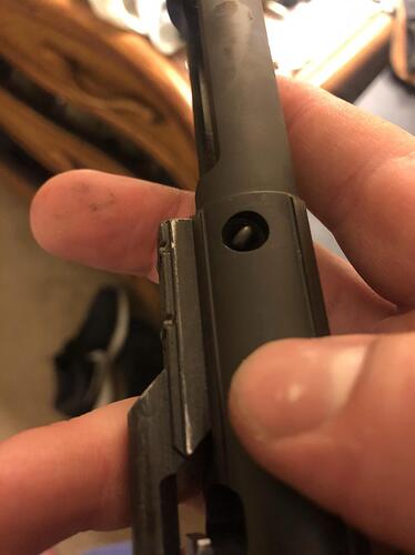

I have a bolt carrier group who’s gas key on the right side looks to have a sort of smooth surface and the finish looks somewhat worn. It was like this when new. You can also see a little bit of carbon above and behind the top gas port hole at the edge of where the gas key meets the carrier. Does this seem okay?
For what it’s worth, I have shot 200 rounds with this BCG in a new rifle that it came in with no problems, and it is from a reputable company. I’ve tried to wiggle the gas key at all to make sure it’s tight, and there is no movement whatsoever which makes me think there’s no leaking. The staking of the gas key screws are quite aggressive as well.
Here’s a picture of what I’m talking about:
https://i.imgur.com/DVP6qBk.jpg
Let me know what you think.
Maybe I’m missing something, but I don’t see a single thing wrong with it. Other than, perhaps, that it’s too dry and needs some Slip 2000 EWL…
I have some shipping here because no one carries it around here. Unfortunately it won’t be here till Thursday at the earliest…
But yeah… maybe I’m making something out of nothing.
Yeah, the whole thing just looks dry as a bone to me. Maybe it looks different in person but unless it looks like it’s wearing to raw metal I wouldn’t think there is an issue.
Never mind - apparently I was seeing things.
Stop examining your rifle with a magnifying glass. If there arent chunks of metal missing and the rifle is shooting fine then STOP WORRYING ABOUT IT.

Doesn’t appear to be anything more than wear marks and initial gas leakage. Unless you are seeing gouging inside of the charge handle,I wouldn’t worry about it. More than likely just a tad more material on the right side of the key during manufacture, potential slight right holes in BC and/or both. Provided no sharp edges, oil and enjoy. If any, knock them down with a file. The staking on the top should be no more than .025 above the key, as a reference, a 1/16" punch is .062

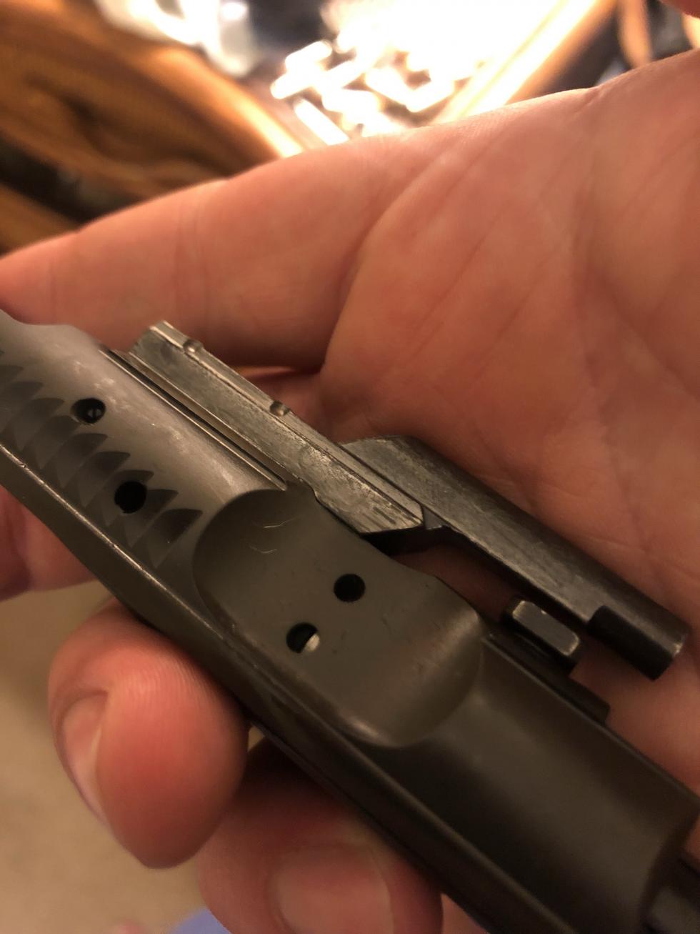

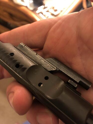

OP, your carrier looked ok to me.
Has that BCG ever been fired?
It hadnt been shot until I put 200 rounds through the rifle the other day with no issues. The finish was like that when I got it. Why?
I think it looks fine. No harm in asking, you dont know what you dont know
Here are two better pics. The bottom one is the “shiny” side (though it’s more like it’s more faintly finished rather than shiny), and the top is the other side of the BCG.
