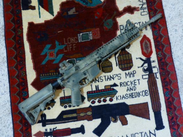

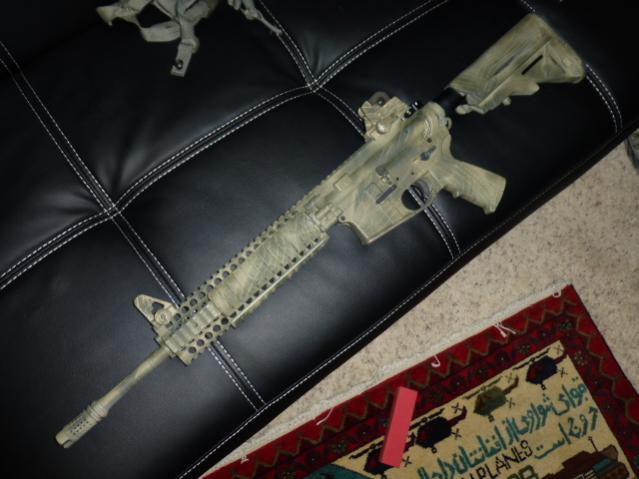

Bastard no BS lightweight carbine
Noveske upper receiver
BCM lower receiver
Daniel Defense Lite rail (old school version… love these!)
Daniel Defense 14.5" lightweight barrel w/ gas block
Colt M16 bold carrier group
VLTOR medium latch charging handle
Battle Arms BadAss pins
Griffin Arms. M4SD FLASH COMP 5 … for total legal barrel length of 16" (pinned)
Spikes T2 buffer w/ Springco Blue spring
LMT iron sights
LMP Sop-Mod stock
Magpul MIAD grip
Magpul aluminum trigger guard
Magpul ASAP
…all other small parts from CMMG. I have a G2S trigger to drop in, but I really like the single stage stock CMMG. I’ll save the G2S for another project.
The BCM lower is from BCM’s earlier days, is an excellent match for the Noveske upper receiver. I cannot stand receiver overhang and /or slop. I know it doesn’t matter, but I’m building the rifle, and I can control what I dislike. These fit like they were made for each other.
Just recently rattled canned it, in flavor of previous deployments.
Eats everything from Wolf to LE223T3, to SS109. :slight_smile: Purely a fun little no BS rifle!

Nice build, but lightweight build with no Keymod or M-Lok? Blasphemy.
I want some weight, the DD “Lite” rails give me that, nice balance… I’m used to Military contour rifles from service. Not sure if this makes sense, but I like that weight is taken away from the front end with lightweight barrel. It isn’t much, but it is noticeable. Balance feels more natural to me than my KMR uppered rifle (Braco Co. factory lightweight). Also, I wanted iron sights on this rifle. The KMR gains a little needed weight from a CompM4.
