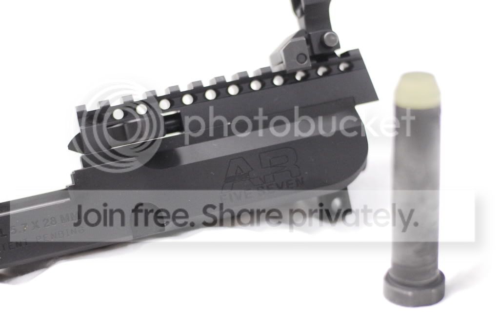

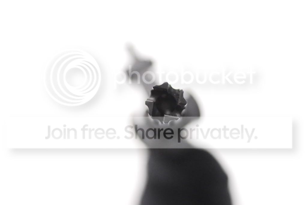

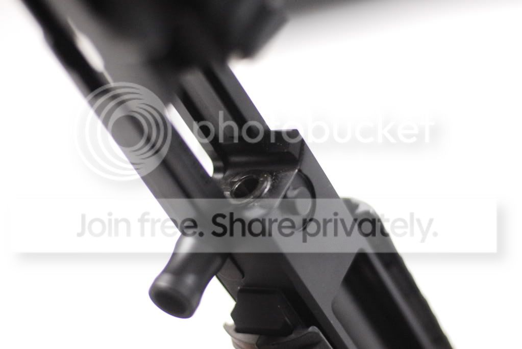

First thought of the upper upon examination…SOLID. One monolithic piece cut from forged 7075 T6 aluminum. According to the website, it weighs 6 lbs. Feels a little heavier than that…I must be getting weak. Buffer weight is a whole pound.
No play in the magazine detention system or release lever.
You can find more advertised specs and nitty gritty details online.

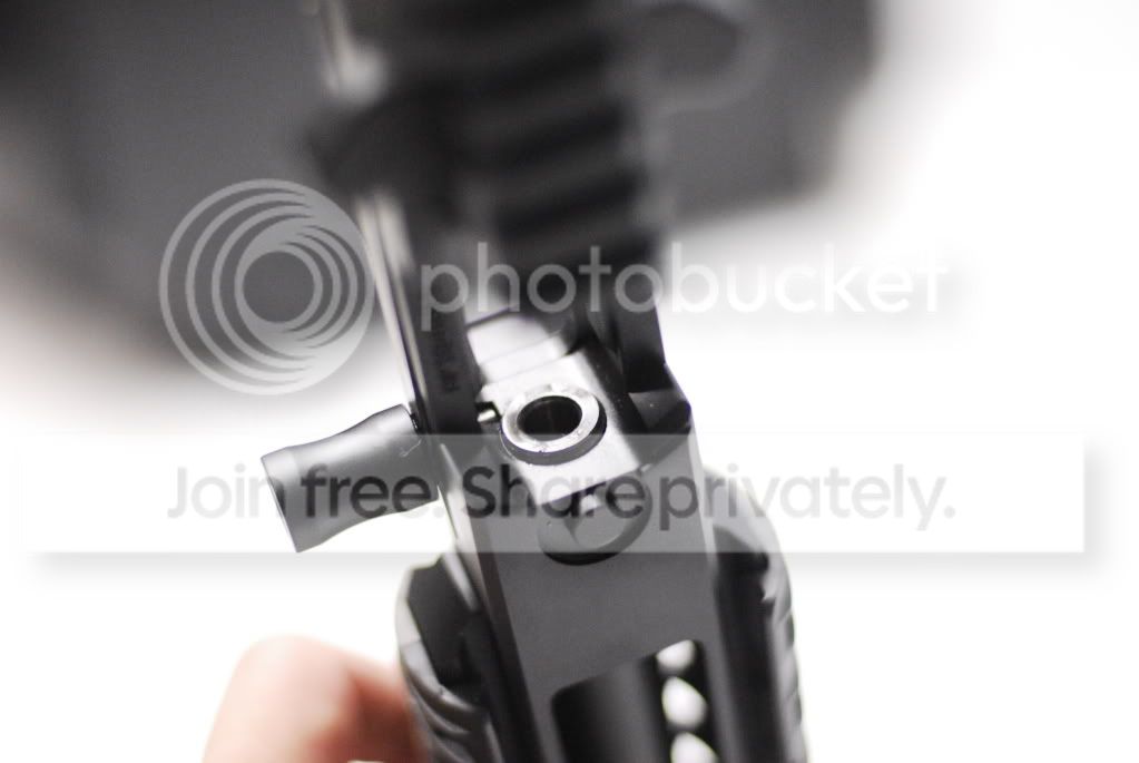

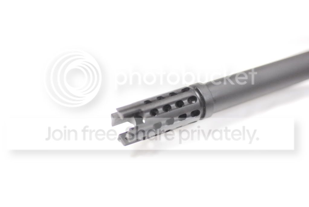

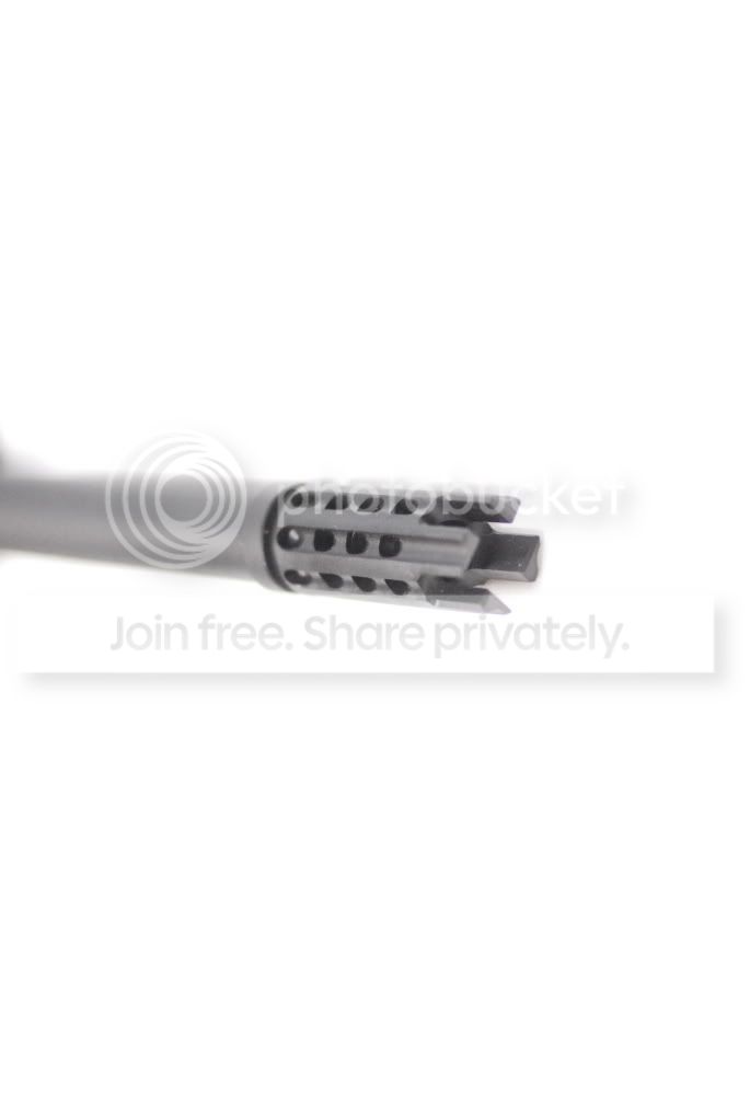

The flash hider was an interesting design. With the amount of holes that it has, it looks like a compensator for a .22LR, but it’s not a compensator because it’s definitely out of the barrel once it reaches this point.

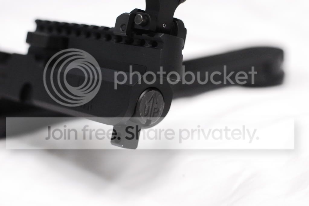

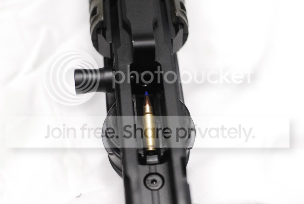

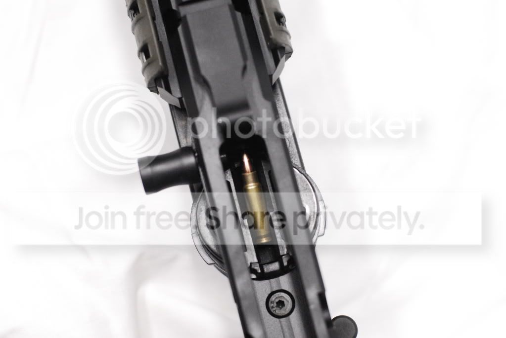

Clean area for a blow-back system. The buffer is so heavy that the bolt doesn’t just engage the chamber, it slams against the barrel chamber hard when charged dry.

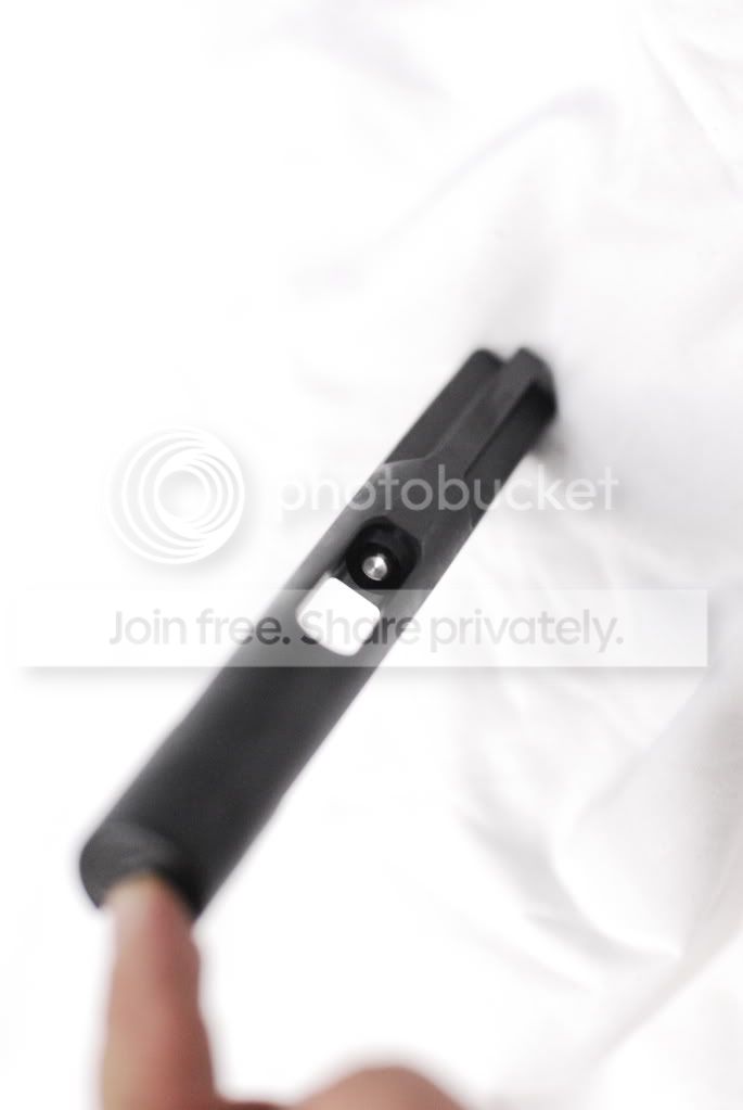

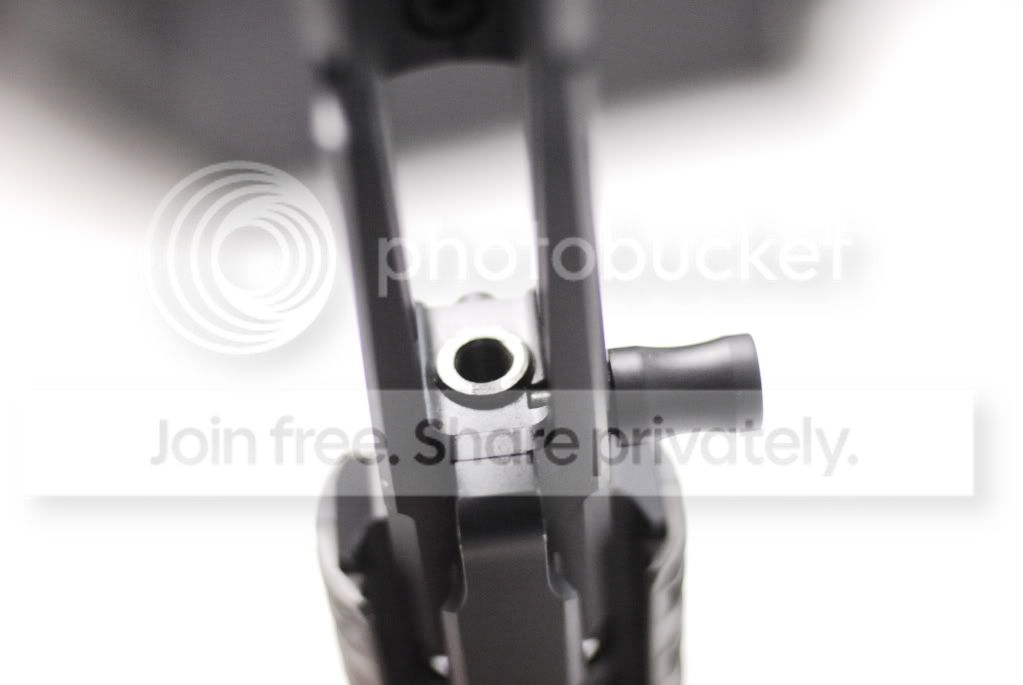

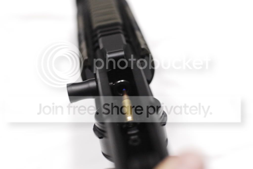

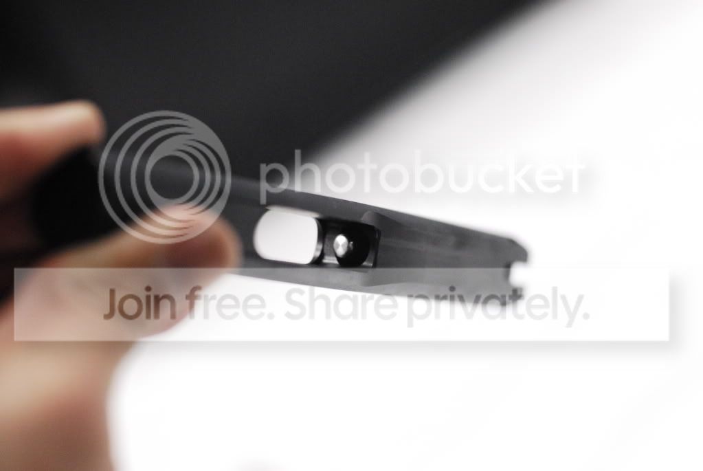

This is how it feeds in the chamber. This is a bottom view. Very clean how the shells are ejected out of the magwell. They’re thrown out from a well designed ejector on the bolt.

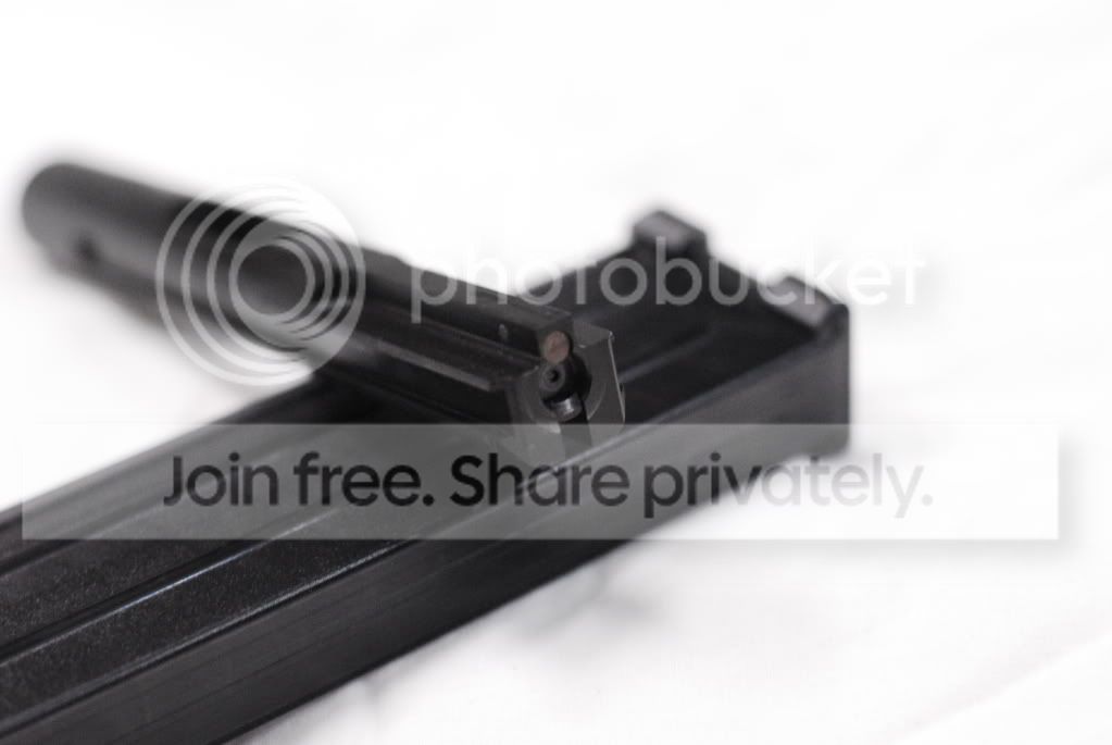

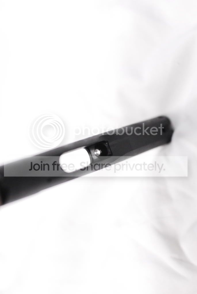

Dummy proof bolt.
I thought the pin bent, but I guess it’s suppose to be high in the bolt.

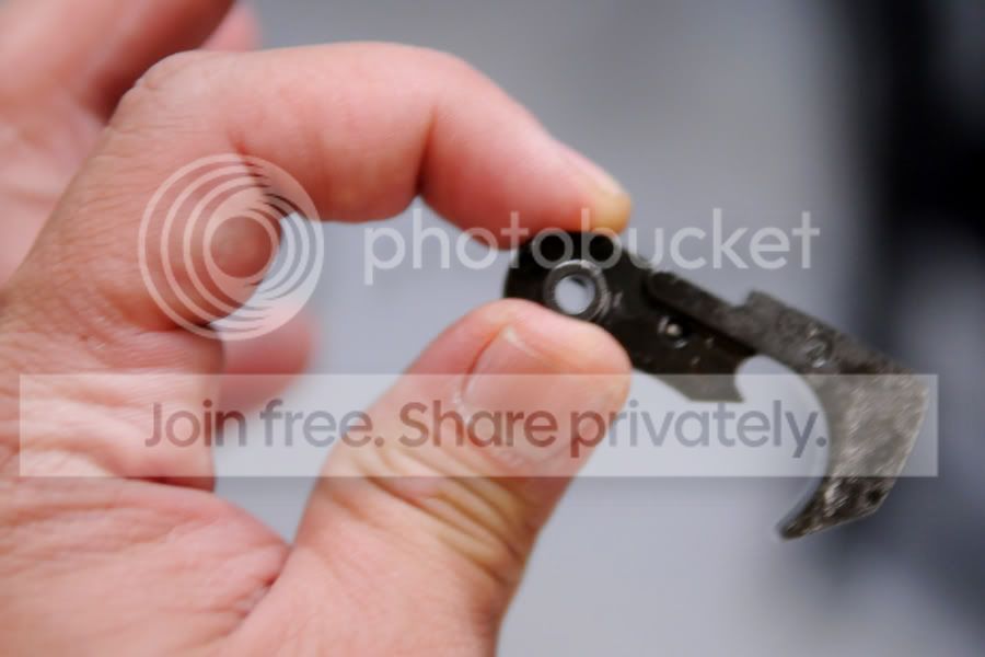

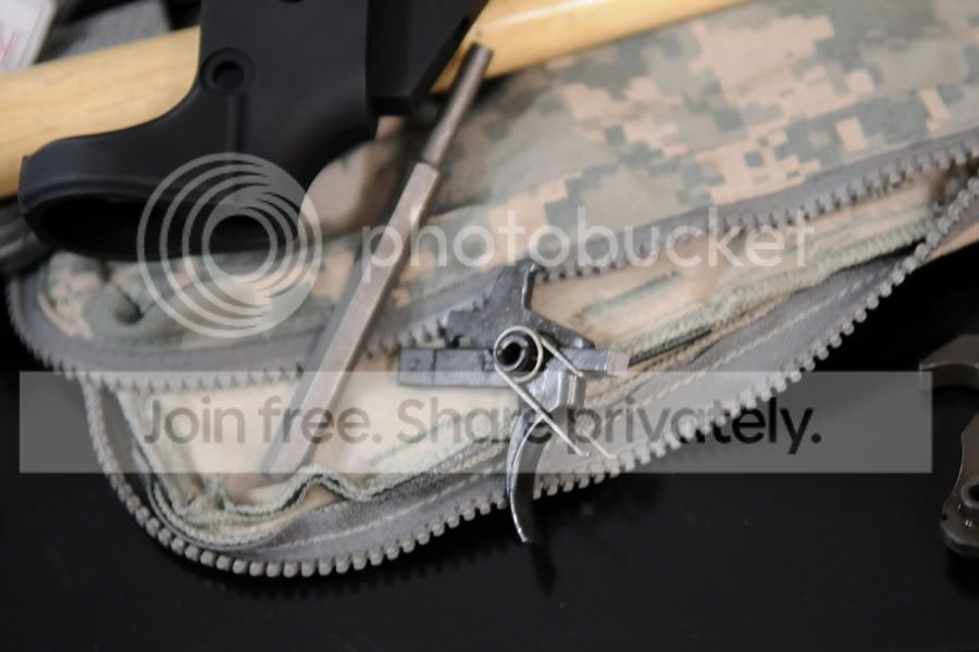

Lower parts went in as usual, but I noticed in the hammer that they used a bar instead of a spring to detent the hammer pin in place. I’m sure both spring and bar have their pros and cons but I thought that was interesting to see the substitution.
