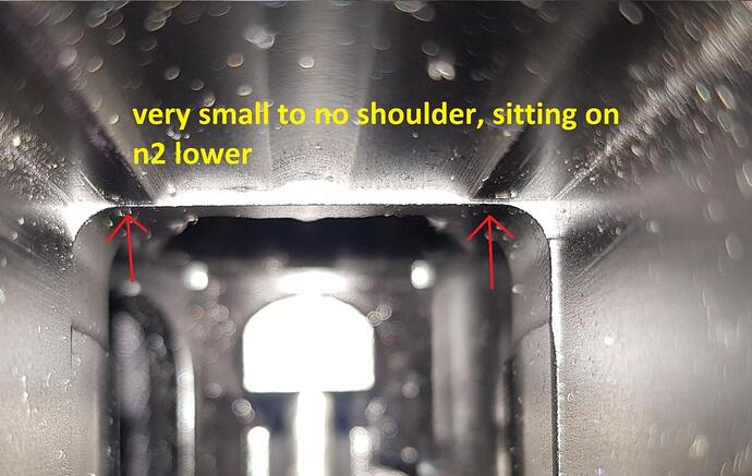

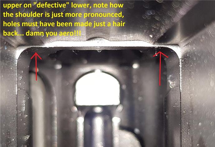

okay taken some very closeup pictures of both assembly, i hope the website shows them properly
so it think this confirms that this lower is “defective”, at least it have the pin holes drilled just a hair back, probably enough to tighten things up.
now… i think a tad of filing wont be a big deal? being an international user, any kind of RMA will take a freaking while… im extremely disappointed tho.
Looks like a pretty big machining error. I don’t think “a tad of filing” is going to fix this.
Where are you? Who’s the Aero importer for you? Do what you like but I think you are giving up any warranty claim if you try to file on the lower to fix the machining defect.

A little follow up for anyone interested;
filed down a little portion of the highlighted zone in the upper, the edit except for the finish stripped out is basically invisible to the eye, seems to have worked good and now mag (tried only p mags) drop free & dont lock in anymore.
not happy to have been forced to touch the non defective part, but at least now things seems to work good.
