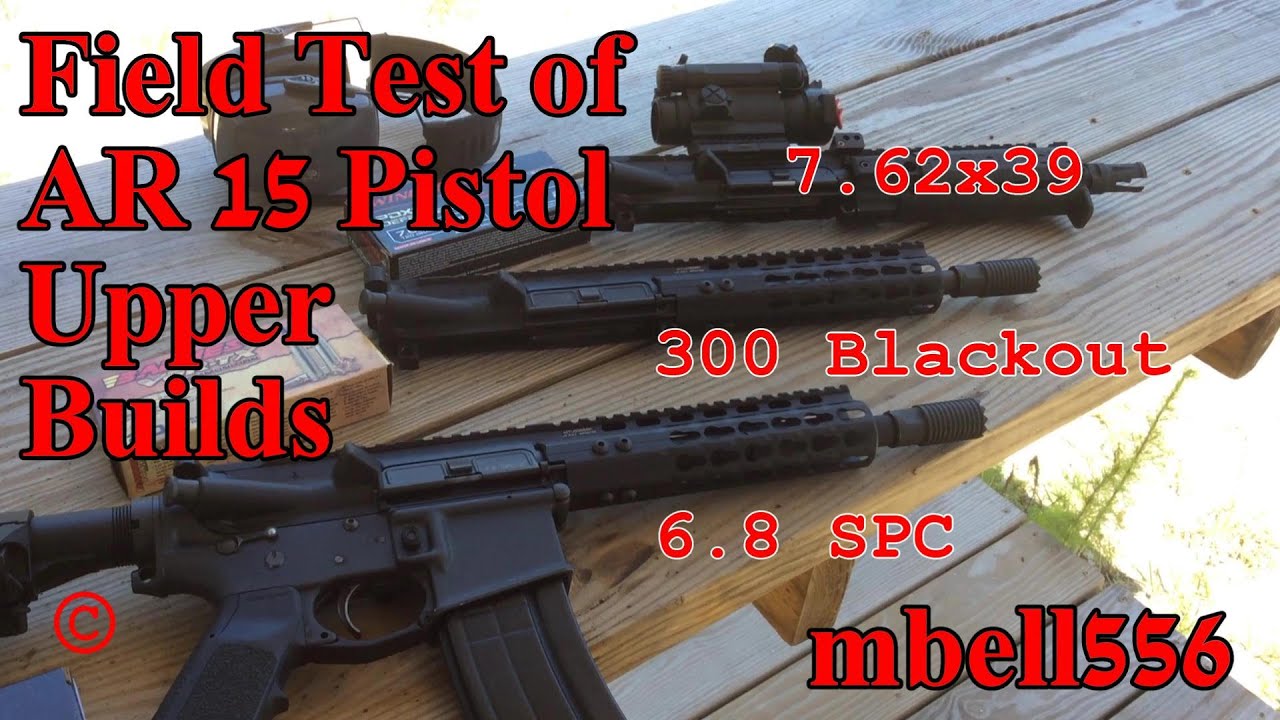

Michael Bell did a decent comparison between 6.8SPC, 300BLK and 7.62x39 through short barrels…
The 6.8SPC came out on top which reiterates the data published by LWRC about their UCIW 6.8SPC PDWs several years ago.
