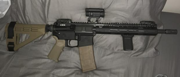

I finished my build this week.
Are Stubbies not considered VFG’s by ATF, or did you get to >26" OAL? VFG + <26" pistol = AOW…
that foregrip is not 90degrees therefore not a “vertical foregrip”
from another thread
ATF said:
For your information, Federal law currently does not define “Vertical Fore Grip”; however, ATF has determined that a grip of this type is distinguished by being both forward of the magazine well and oriented at a perpendicular (90-degree) angle to the bore of the weapon.
Interesting… ISTR that when Auto-Ordnance pistolized the Thompson they had to maintain above-26" to avoid AOW status with the classic 45-degree-ish “Chicago Typewriter” foregrip. I do know that Magpul AFG and FAB PTK are considered non-AFG since I have their Determination Letters.
It is over 26 inches, not by much though.
I’m also interested in more information on that canted/slightly angled forward grip…I have 2 or 3 of the BCM style “canted” stubby vertical grips and would love to put one on my pistol in place of the AFG currently there…does anyone have any other links to threads or documents that have more information on that?
