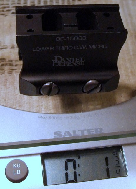

Daniel Defense Aimpoint Micro Mount: 1 3/4 oz

1 5/8 oz or 46 g.
