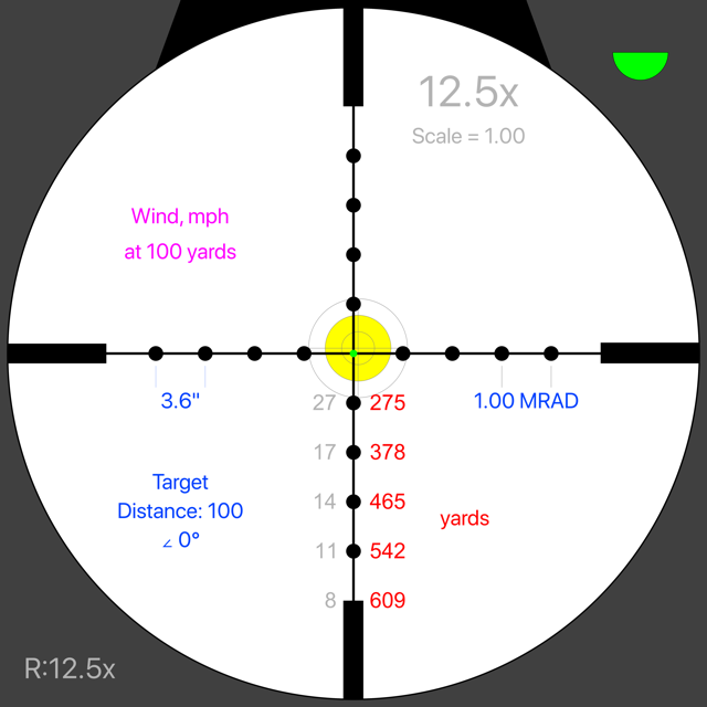

Or just stop being poor and spend the $10-15 on Strelok or Strelok Pro and get the drops for YOUR rifle + optic and YOUR conditions instead of using someone elses data under unknown conditions which may not be correct for your set up and conditions.
Eggzakry.
If you’re serious about trajectory from A/B/C gun/rifle/optic, this is the easy button.
The first time I shot at 600 yds with data from Strelok I was amazed at how close the data was.
However, the info still needs to be verified in the field.
Where are you finding chronographs for $10-15? Does Strelok send you one? Or does the software calculate muzzle velocity all by itself through some super-fancy server-side fluid dynamics simulation?
not to pick nits, but your windage “lines” should be curves. as the bullet slows down, the wind has more time to act on it. so a given wind will push it farther at 800 yards than it did at 400 yards because it’s moving slower at 800 than it was at 400. as diagrammed, you will over correct for wind at closer ranges, but perhaps not by a large amount. it’s probably acceptable if you just sketched that yourself for use with a carbine and m193 or something, but i’d hope a ballistic calc would be a little more precise.
Hello, I am considering getting a chronograph, but don’t have much use for it once I get my velocity with Fed. Gold Medal .308. I am first going to try using my actual point if impact at 100, 200 and 300yds to adjust the fps in Strelok until the software aligns with the sctual POI. Theoretically, that should eliminate the need for buying a chrono.
Sent from my SM-G960U using Tapatalk
There are ranges where you can rent one or ask the next guy you see at the range if he can chrono your loads. Always offer to replace if you end up shooting his chrono though.
Strelok+ has a Trajectory Validation feature that let’s you figure out the actual muzzle velocity.
