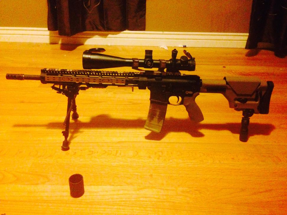

Hello,
I have been toying with the idea of upgrading my Ar-15 DMR/SPR rifle currently chambered in .23 Wylde to 6.5 Grendal. To do so requires few parts: barrel, bolt, and mags. Those are the basic components to convert to a 6.5. However, per a conversation I had with a gunsmith the conversion can often be not so simple. According to this gunsmith problems often arise, mags that function reliably are hard to find and the rifle can be prone to malfunctions sourcing from the gas system. His thoughts are initially it may seem like an affordable upgrade option but many issues can arise which end up costing a good deal to fix/troubleshoot.
I am not a gunsmith and have very little technical skills/knowledge so any work done on the rifle would be outsourced to a gunsmith on my dime. After the conversation with the gunsmith I am questioning the upgrade. The way I had planned on doing it I was going to purchase a barrel/bolt from Lilja and go from there. I know that buying a complete upper would be intrinsically a more reliable system but I want to keep costs down.
I use this rifle for mid-long range target shooting. I have not yet, but at some point would like to go after hogs with it. It has a hi-powered scope and is set up well for this application. The 6.5 conversion would basically use everything I already have replacing only the core components (barrel/bolt/mag) to 6.5G. Below is a photo of the rifle for reference.
Any thoughts on the topic or experiences with 6.5 any forum members can share will be greatly appreciated.
How exactly are you shoving the capability envelope of what you have right now? It’s a small (thumbnail sized) picture, but that looks like a pretty capable setup - feed it some 75gr-77gr match handloads and you should be in pretty solid shape out to half a mile for target work, the 6.5 Grendel (running up to 123gr bullets) will absolutely outshine 5.56 in that range where the lighter projectiles fall off on wind performance, but if you’re not out to there then I’d at least look into running what you have hardware wise with ammunition more specifically suited to mid-long range target work.
As a minimal cost answer I’d look into that first, maybe as a stopgap until you can get a complete upper as an answer (I’d argue that’s a much better solution for all the minor reliability niggles you’ve pointed out, having a complete built upper at least narrows down some of those since you have another known-good upper to troubleshoot and compare against.
Thanks very much for your reply. At the moment I am unable to handload (temporally staying at a friends house while searching for a new place to live) but using top quality ammo, with the specs you mentioned does work well for punching paper. The desire for a heavier projectile is for the hogs, and possibly pronghorn here in CO. I think that you make a good point and I should have mentioned this in my original post. From your suggestion I gather that you recommend spending the extra cash and going with a complete upper. Any specific brands?
  • Sorry about the photo, forum would not let me upload the pic in original size… I will upload a larger copy. Thanks again.
Tiny again… I am new to the forum so dont know if I am screwing this up or it should to be like this… When I click on the pic a pop-up with an enlarged view appears.
