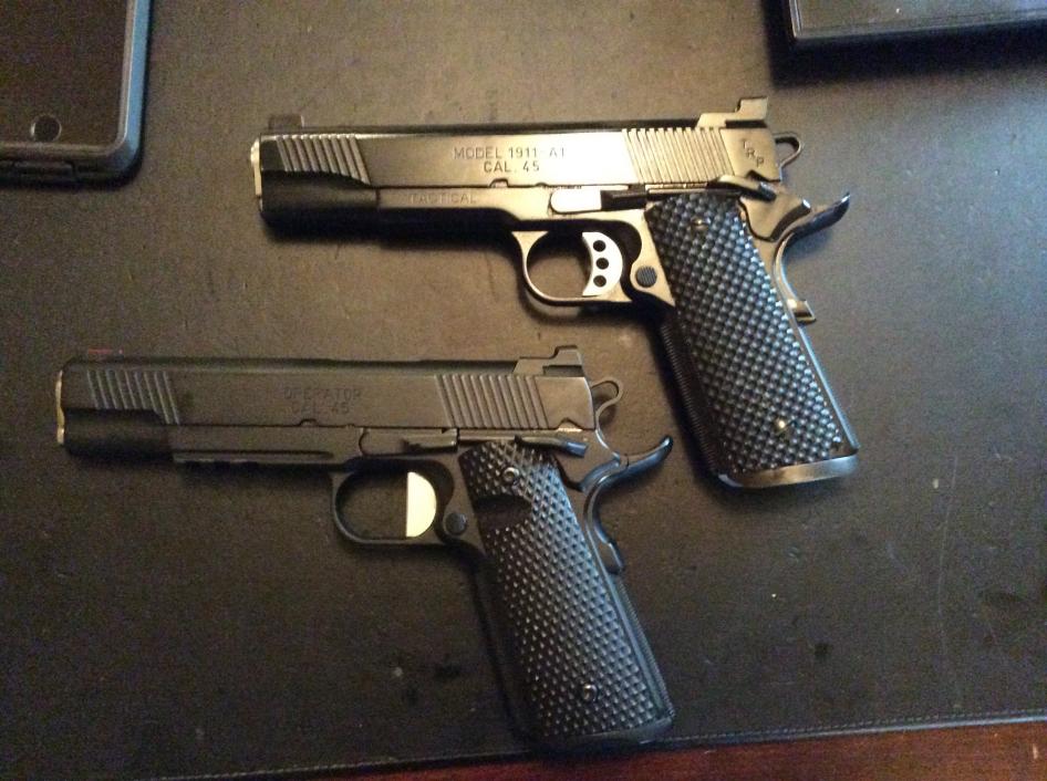

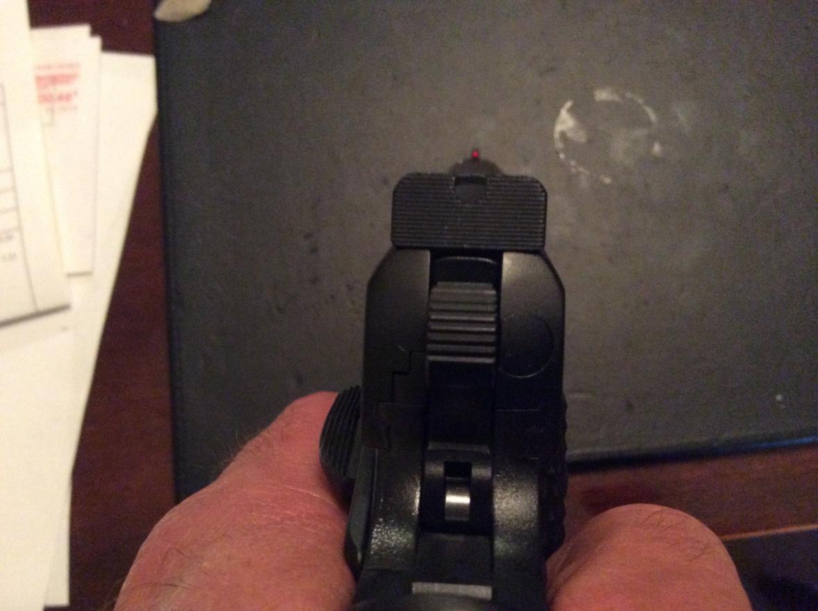

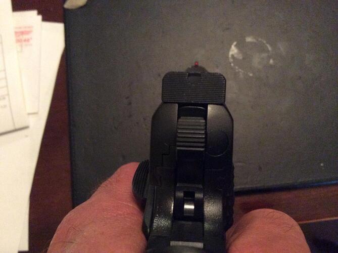

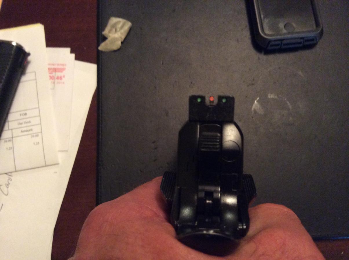

I installed the TRIJ HD AND Dawson precision front fiber optic.
The HD’s went on good, the rear very nicely , great fit. The front went on too easy, it had to be tapped in, but not much force needed. So we put some JD WELD to secure it. Anyone ever done this with or without success.
The Custom MC Operator now sports a rear 10-8 and Dawson front. If it shoots POA / POI, I will be thrilled.
The front Dawson was a perfect fit. Tapped in with the perfect amount of force. Again, fingers crossed for POA / POI.
MY HD’s didn’t have the set screw in it. I don’t feel I need it, but doesn’t hurt. Can you buy those readily. I have not checked yet.
