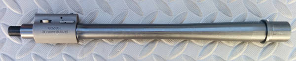

The reason I’m even considering this is this barrel/gas block combo I ran across that looks intriguing…
http://micromoa.com/12-5-midlength-5-56-nato-1-7-medium-contour-barrel-w-govnah/
I have no affiliation with the company.
I would expect it to be a picky eater. 16" rifle gassed “dissipators” tend to be hard to make run well, and this is a similar concept.
Depends on the gas port size. And that Govnah?? gas block. Properly ported 12.5 carbine barrels can have very little impulse. I know a few guys on here that run 12.5 mids and have great results with the barrel ported properly (aka large) to run reliably. If running a suppressor I would say go for it. If not, I would rather spend my money on a properly ported barrel and run an A5 system to achieve same results with increased reliability.
I have no experience with Govnah so I don’t know what if any part that plays in the system your looking at.
