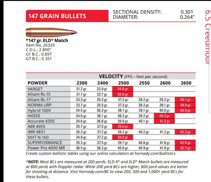

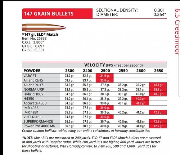

I just did some ladder testing for my Aero based 6.5 Creedmoor. This is from a 22" Rainier Ultramatch barrel with a rifle length gas system and SLR Sentry 9 adjustable gas block.
I worked up from the middle of the charge range to the max charge published in the Hornady manual for H4350 using a 147gr ELD Match. Actually, I went .1 grain over the max. Charges were 38.6gr - 40.4gr. Primers I used were CCI 200’s.The brass was twice fired Hornady sized with the shoulder being bumped back .004. The cases were trimmed to 1.910 and projectiles seated for a COAL of 2.795. I haven’t checked the distance to the lands yet. This was just looking for the starting group. As charge weights increased, there was some flattening of primers and some slight cratering. No swipes were encountered. I use a standard 308 bolt, not one of the HP offerings. Maybe I’ll change it out at some point.

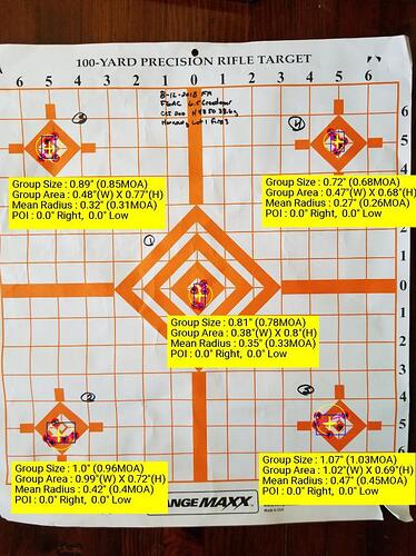

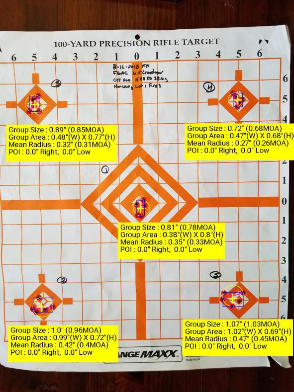

For my rifle, the 38.6gr produced the smallest group. I went ahead and loaded up some more tests using 38.6gr to test repeatability.
Performance wasn’t bad. Average velocity was 2543 fps. Brass and primers were all in good shape. Given the atmospherics (93° F/59% H, 30.02 in Hg ) JBM showed max range at just below 1400 yds. SD was a little high, but I’m thinking the rounds were getting heated in the chamber. My reasoning was there was an increase in velocity when I took longer to take following shots. I have some more work to do with this load. I am thinking of trying some of the Alliant powders since some have posted interesting results. Bolt gun may be able to mess with more and wring some more out of it.
These are the results:
