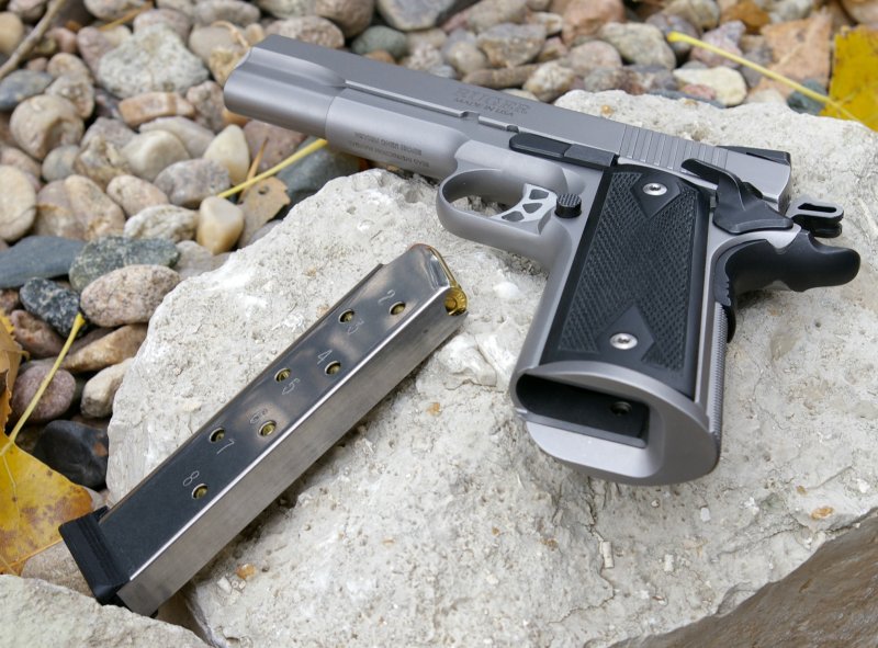

I’m a proponent of magwells on 1911’s. I believe Ken Hackathorn is as well. I’ve used several, from Ed Brown, S&A, EGW, etc. The best standard profile magwell is the Wilson Bulletproof.
Take a look at the difference:
S&A
Wilson
See the difference in the size and angle of the well? Obviously to maximize the effectiveness of the well, it needs to be blended to the frame (as the Wilson is).
If your gun is for carry, one other option I’d strongly consider is the Chen Magwell Suite. It’s pricey as hell, but it offers all the benefits of a magwell with no downside for a carry gun.
I have 1911’s with magwells and without - to me it depends on the intended use of the pistol in terms of installing one or going without - as well as the design intent ( carry vs duty vs retro vs classic )
I will say this ; after using and installing the S&A magwell for years the Wilson Bulletproof one is hands down the finest of the magwell/mainspring housing type I have ever used - my current Supergrade training 1911 has one and it is superb
If you decide a magwell is a good option for you then do yourself a favor and check out Wilson’s version - you will be glad you did
