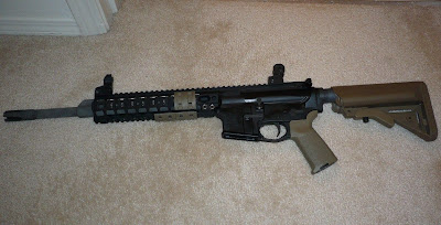

Here is my rifle length with a 16in SS barrel. Second pic is with a 14.5 barrel.

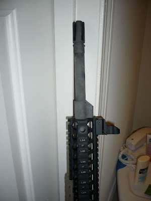

Here’s picture of my 16" cut to 14.5" with Smith Vortex.
