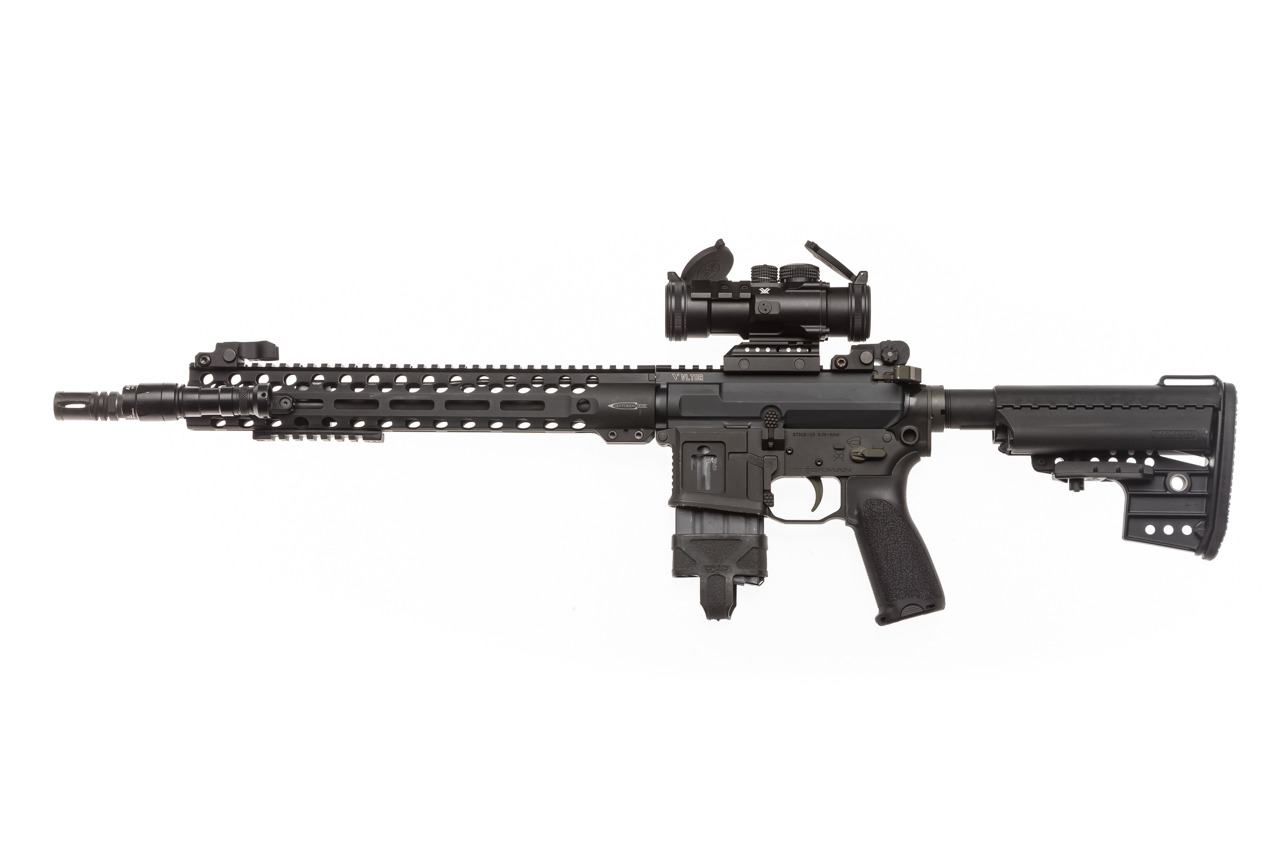

As far as the buffer tube…LMT makes a solid one. I like the SpringCo springs, VLTOR buffers.
Vltor makes a great stock, as do others. In the Vltor stock line up, the below is my favorite currently…
