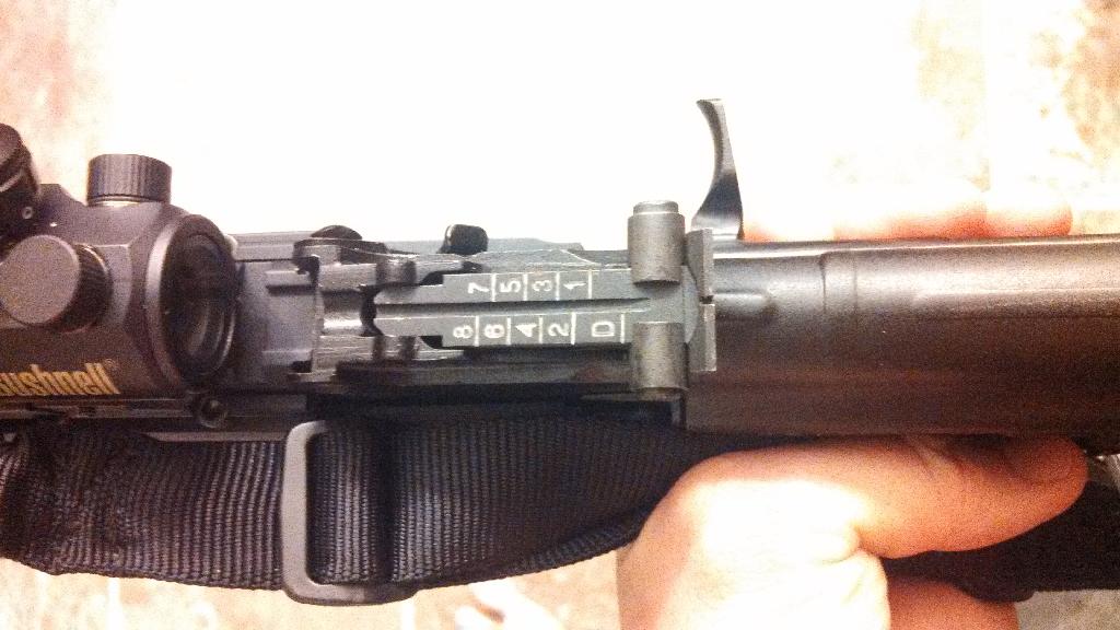

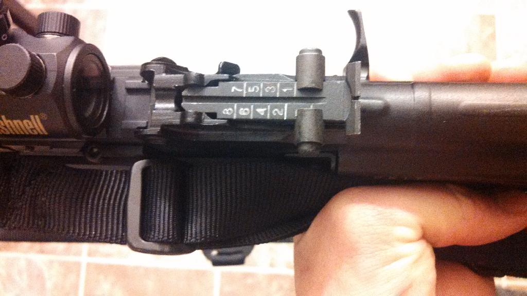

Maybe I should snap a pic where I have my rear set at…I believe it is set to 1, and below that is a letter (I’ll look at it when I get home). I have an Ultimak rail cowitnessing a red dot. I am dead on at 25 YARDS (not meters). Then I go out to 100 yards and my hits are about 10" high just like the old method says it should. If the 50 yard zero gives me a more flat trajectory I will do that.

So this is where I have the rear sight set at.
or should I have it set here?

Thank you for this info. Should I zero my iron sights and the red dot the same? I am sure the answer is yes. If so, what setting should I set the rear sight to when doing this “D” or 1 like in my pics.
