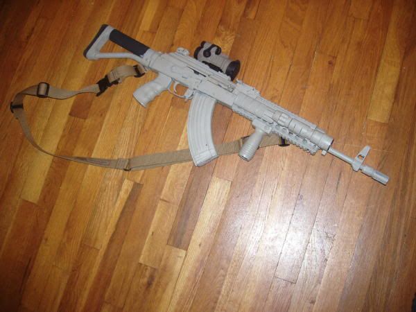

Vickers lefty setups, this time on a M92 and A1R.
MM…
Nice set up there. Could you give some details on the rifle itself? I’m especially interested in the stock (what kind, how it is installed). I am also wondering how the front sling is attached - did you modify the lower hand guard?
Thanks!

it’s an old ACE stock when they were using M249 stocks. i cut it down in length to suit me. it’s installed with a internal receiver block:
http://riflestocks.com/AKStampedModsRequired.htm
the front of the sling is just attached with an uncle mike’s wood sling stud and swivel. no mod to the handguard.

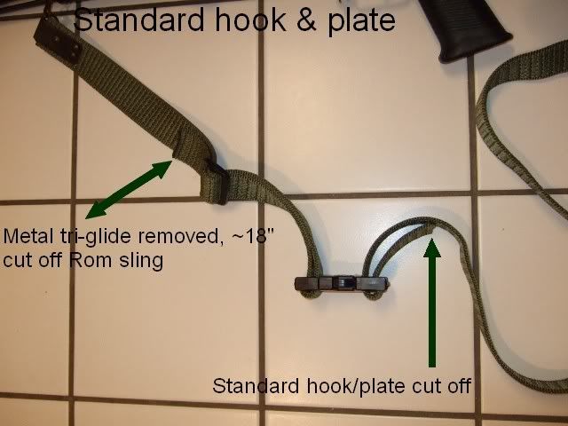

Not sure if this type of sling has been posted before, but thought I’d share last night’s project.
I sacrificed a spare Romanian sling so that I could attach a Larry Vickers VCAS sling using the stock hook and D-ring.
I was thus left with some webbing. What if I attached two AK slings together?
While it lacks the rapid adjustment of the VCAS and VTAC slings, it does put otherwise useless AK slings to work.
It attaches/detaches pretty quickly so that you can move it between rifles. (slings are a PITA in a safe IMHO)
And if you have to ditch the rifle, the side-release Fastex buckle will do it.
I found that putting a Fastex buckle by the stock interfered with cheek weld.
Sling one: use a knife to cut the threads holding the metal tri-glide in place. I cut 18" off of this sling when I was done.
Sling two: remove metal tri-glide, and cut the webbing by the metal plate which holds D-ring.
