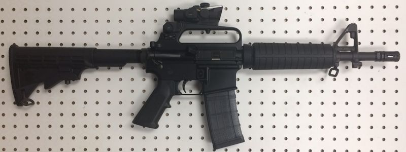

I have a TA44 on my Bushmaster SBR. The clarity is great and I do like it, but I do have to put my head further forward than I typically do with other AR15’s. The 2.4" eye relief specification is accurate. If you go with the TA44, the mounting position is going to be critical. I like the TA33 better, but it’s bigger and twice the magnification.
