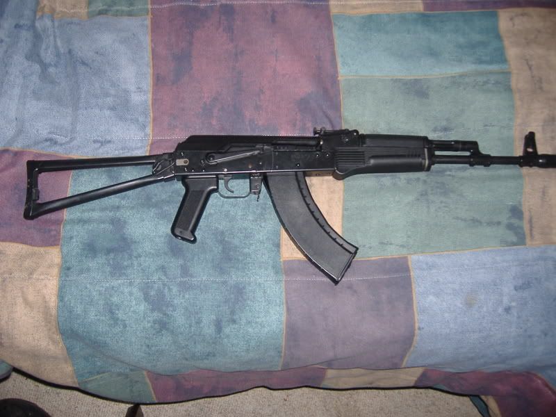

Of 2 AKs, both have folding stocks. One is an AK-100 folder, and the other is a triangle folder. The only reason I have the triangle is for cool factor and “correctness” (can’t have an AK-100 folder with a wood fore-end, and I didn’t want to buy a new full-set of black polymer). The AK-100 folder is more practical. Best stock for the AK.

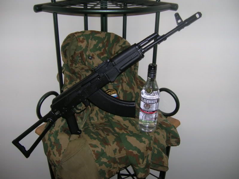

The ability to be discreet can be very valuable. My side-folder equipped AKs will fit in tennis racket cases or other bags that don’t scream “gun!” In a liberal state, this can save you some headache. Durability has never been an issue for me. Lockup is extremely solid.
Don’t forget, any rifle with the triangle side folder can be swapped out for the AK100 series plastic side folder very easily.
This isn’t actually correct. Most triangle folders use a 4.5mm pin and a 6° angle trunnion. AK-100 folders use a 5.5mm pin and a 4° trunnion. Putting a triangle on an AK-100 folder will be loose and floppy. Putting an AK-100 folder on a triangle trunnion won’t fit in the pin and the angle would be wrong.
The exception to this is the NEW triangle folders from Russia, built specifically as an option to work on the new AK-100/Saiga trunnions. But you can’t take a Tula krink and put a polymer stock on it without modifying things, or get a Bulgarian triangle and put it on an AK-100.

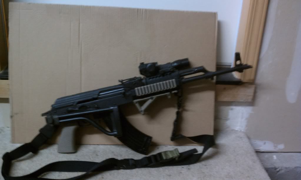

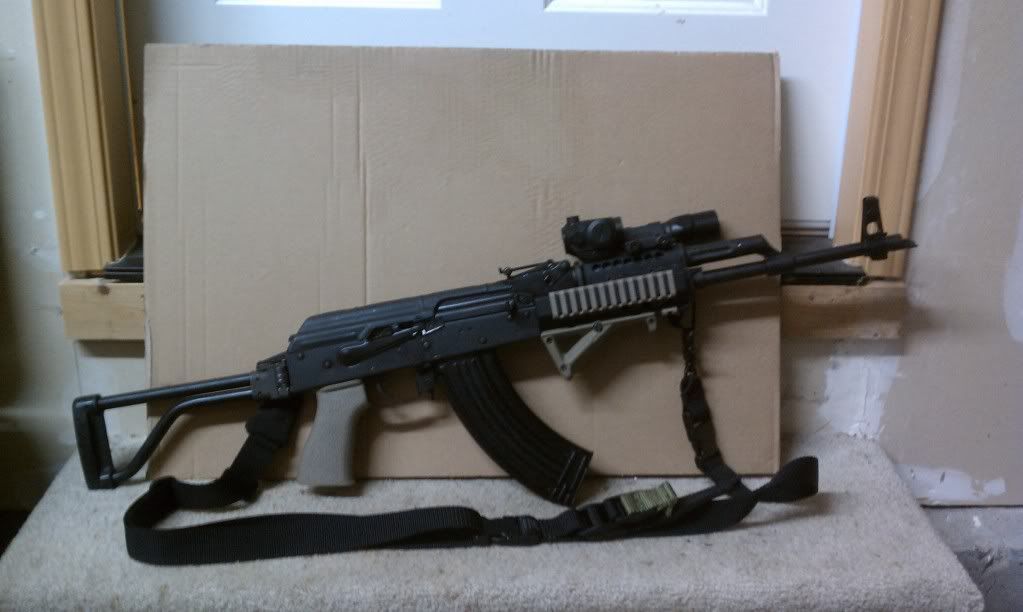

I got a Yugo underfolder as a compromise, and primarily for storage considerations, As a truck gun. A sidefolder is better and stronger, but also wider with the stock folded, which may ALSO be a storage concern. It was in my case.
